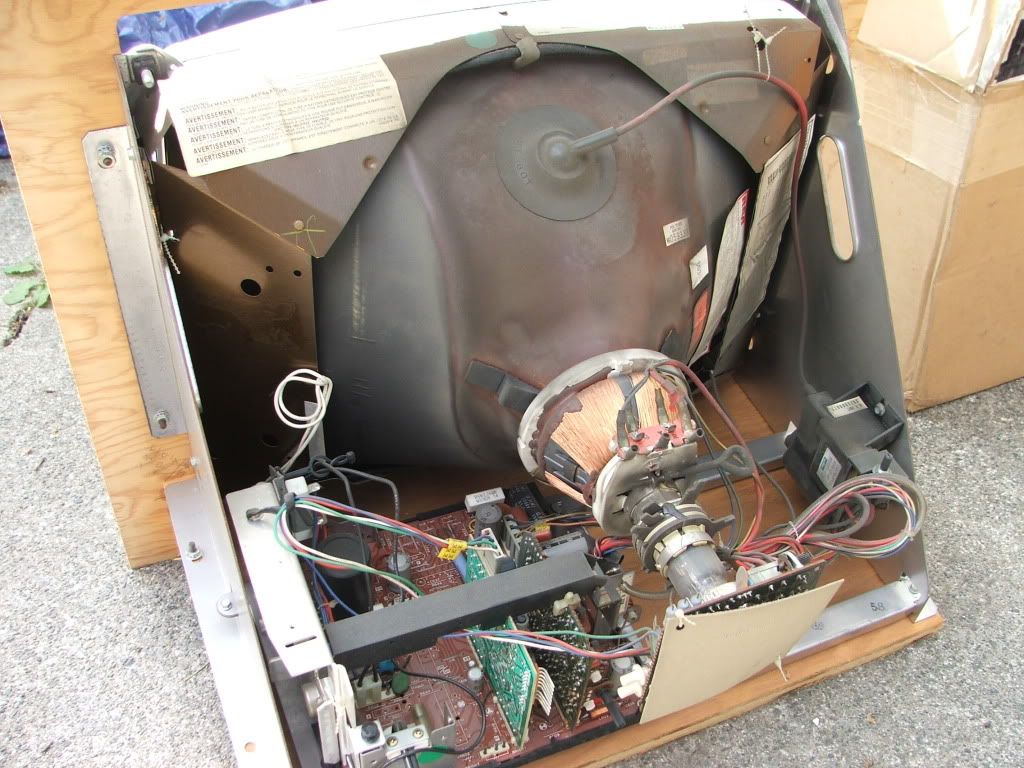

i pulled the WG K4600 out of my Venture today so i can cap it before the Seattle show next weekend and to my surprise the monitor that came out is in pristine shape. i've never seen one this nice in a working game and i'm pretty darn certain it's never been touched by a technician; i suspect it's never been removed from the cabinet before.
virtually no screen burn and a super-clean chassis even before i do any dusting... i almost feel bad doing the work but it needs to be done.
there might be a few other untouched K4600's out there but i doubt there are more than a handful.
I have one like that in my HUO(?) Pac-Man. It's a shame that it still has to be capped. I also have a 4900 in pristine shape in my Port-Man.

Sure you should cap it. The electrolytic caps are 30yrs old.
i'm going to cap the monitor because it's got a skew to the right on the top 3" portion of the screen. not bad and it's still playable but i figure i've got kits so i might as well.
if it didn't have the skew i'd probably wait until after the show just in case i mess anything up; i don't have a spare working K4600 chassis to put in there and i'm running very low on any spare monitors.

Nothing wrong with mine, just preventive maintenance.
I'll bet there's actually quite a few virgin K4600s, because they suck to work on. ;) I'll put up with a mediocre picture from a K4600 (and those stupid Nintendo monitors) to not have to pull that chassis, compared to a normal chassis that's easy to pull and work on. Laziness is a powerful thing. :)
DogP
the only thing i really don't like about them is detaching and reattaching the HWC; otherwise it's not too hard to leave the flyback on the frame and roll the chassis back and forth carefully.
it's a project for another night as much of this evening has been spent piecing Top Speed and Bosconian back together.
