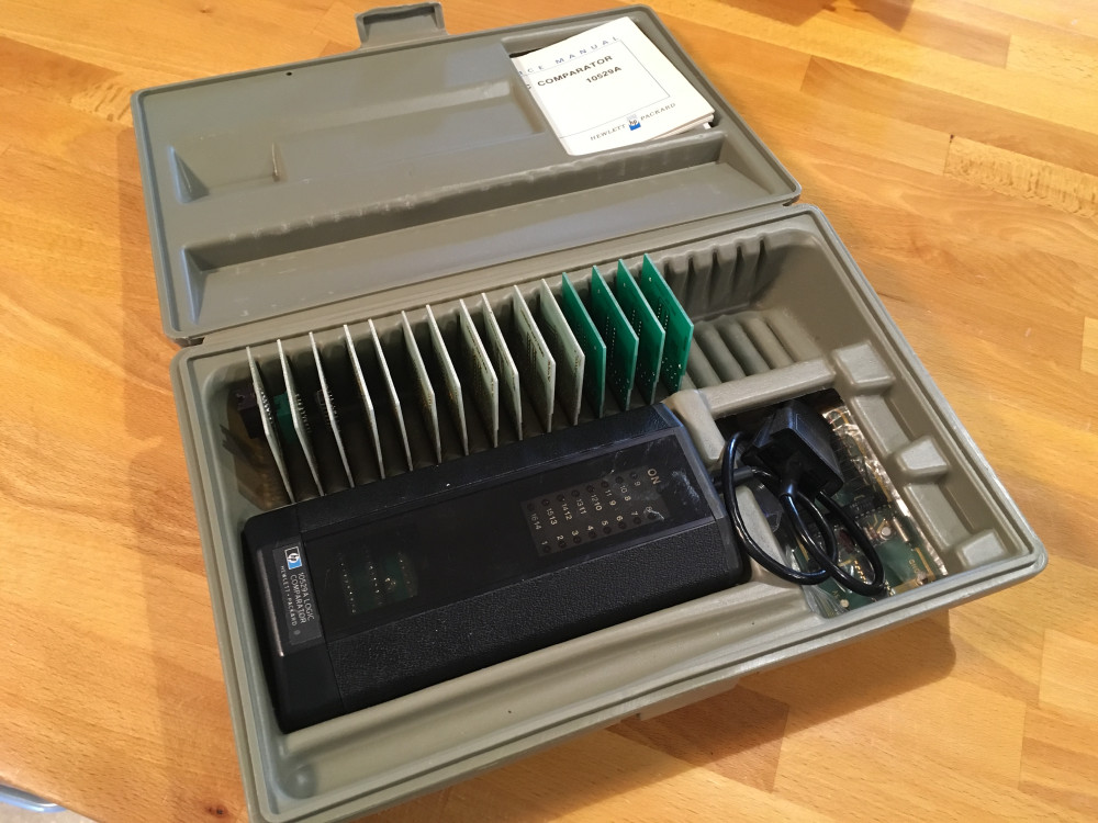

I received the Comparator yesterday, I'm pretty happy with it and for $200 shipped I think it was a pretty decent deal.

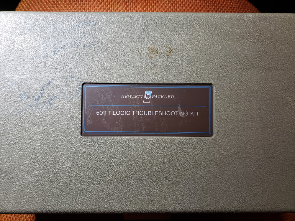

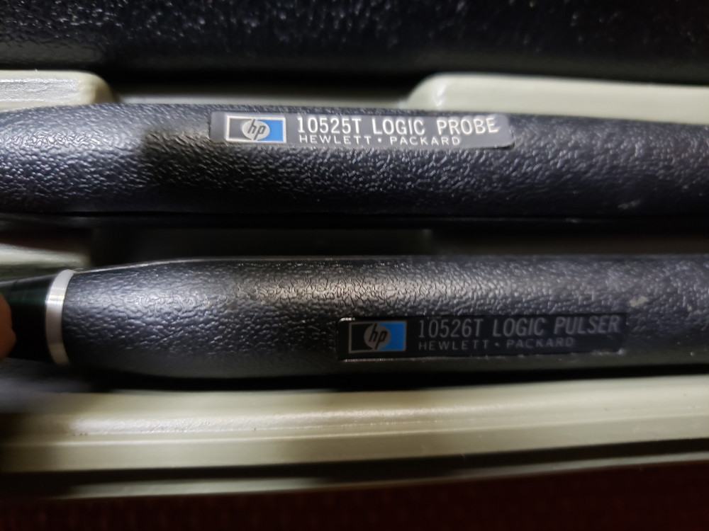

I have the 5011T kit. Includes probe and pulser. Very nice "complete kit", IMHO. :)
I've had this for about 25+years now? Can't recall what I paid. Wasn't much. Glad to have it.

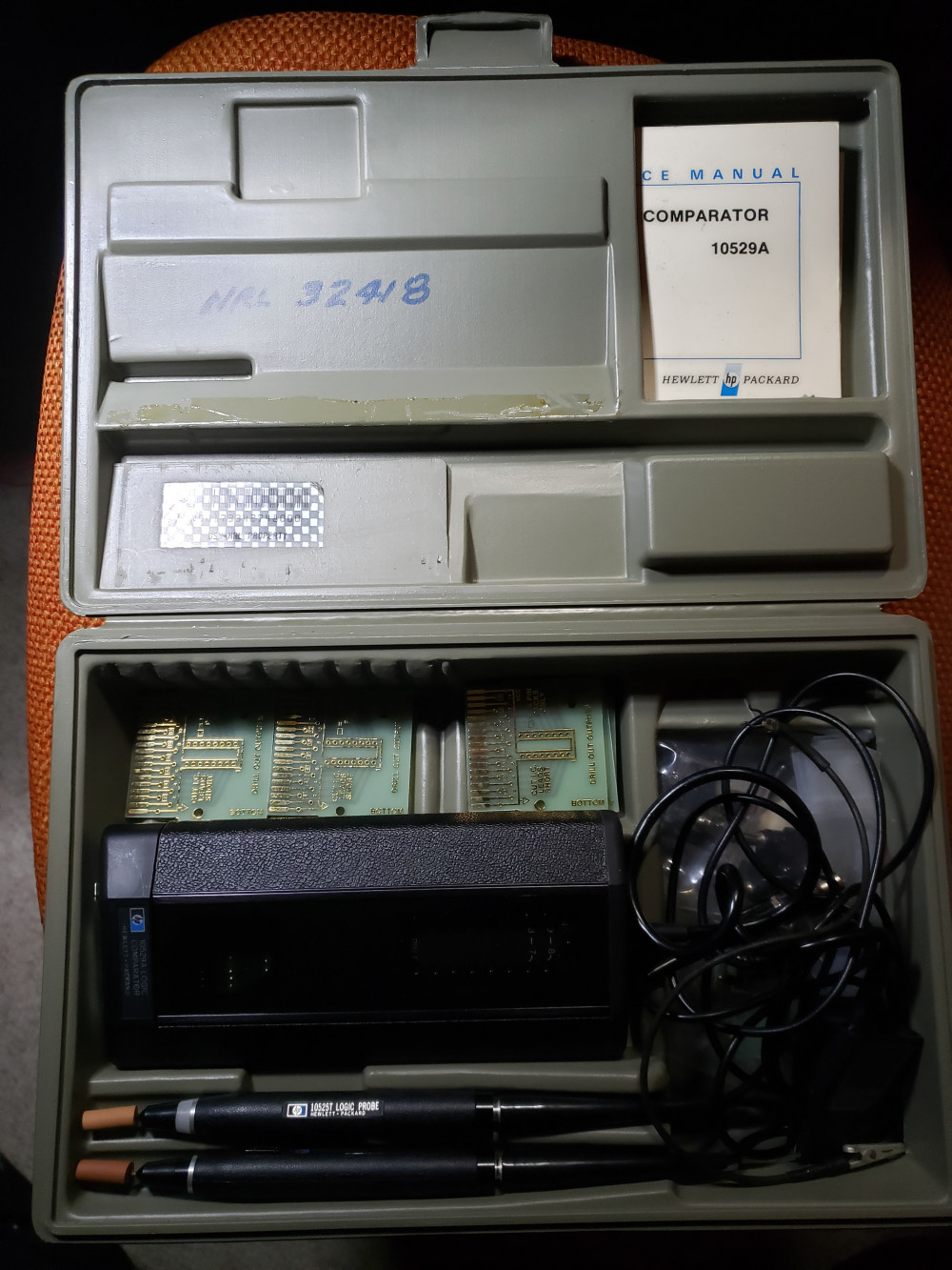

Ha, I was using one of my 10529A comparators just yesterday.

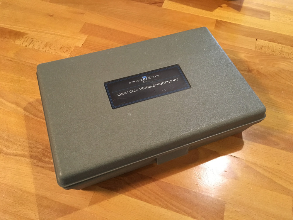

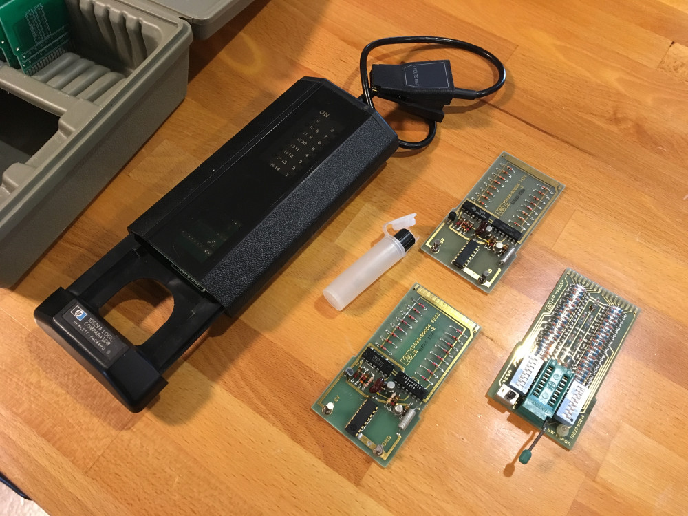

From comparing cases it looks like my 5010A kit would have come with just the logic probe but not the pulser. I wouldn't mind picking up a 10525 probe at some point just to complete the kit.
Current Tracer is nice for finding shorts on a shared circuit. I don't have a data clip either however the universal board can function as one. When I had to fix mine, I was surprised at how little there really is inside of them and how much HP charged for it. Those 74L86s were difficult to find.
