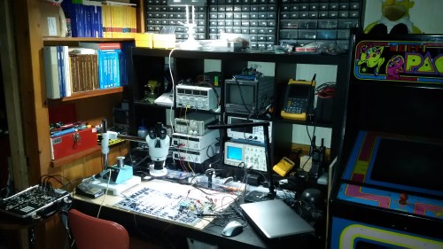

Is that your test bench? I like the Pac cabaret right there.
And yep. the shelf of databooks adds a little class to the workbench for sure.
She's a Ms PAC upright with Clay kit (and marquee). :)
Yes, my work area is all about "class". That's where all the magic happens. The books are also "JROK approved". LOL
