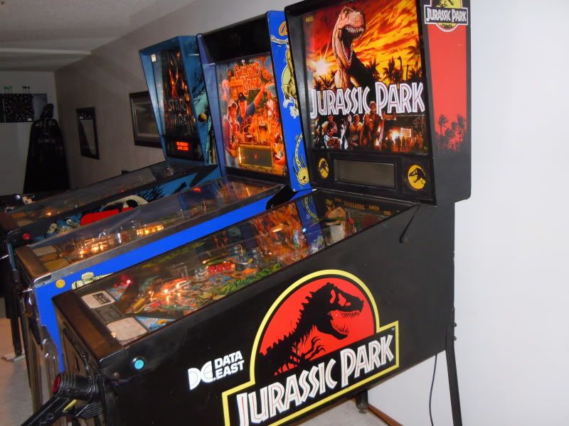

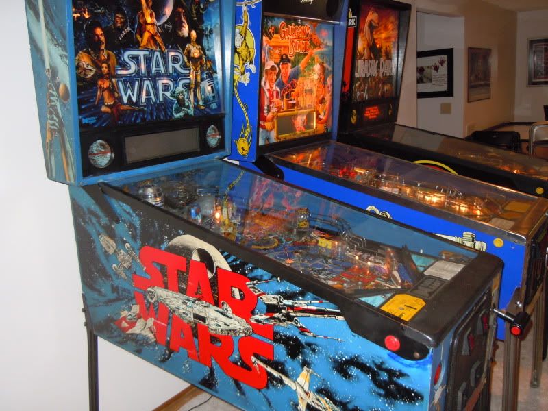

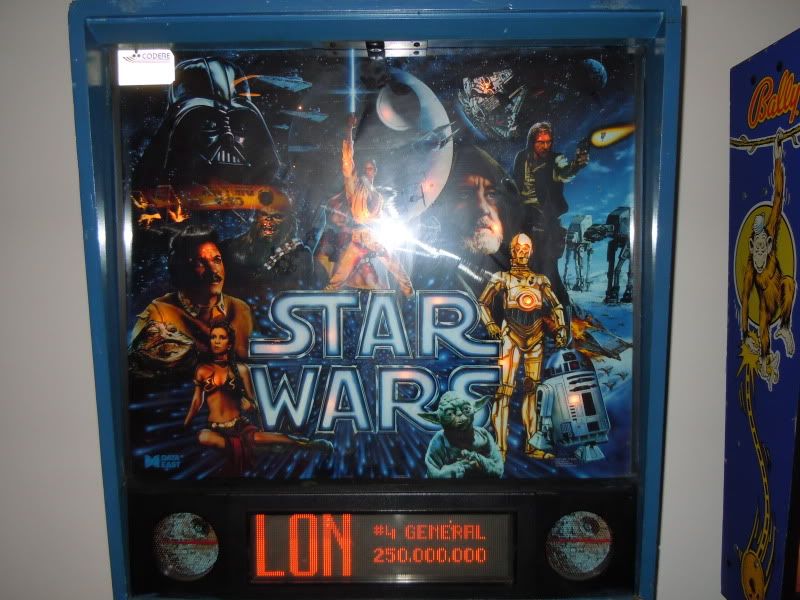

i finally have a "pin row" instead of a lone pin.....picked up a jurassic park and a star wars (DE) yesterday.
i know the term gets thrown around often and is kind of poo-pooed by some, but star wars IS my pin-grail. it's the only pin i played "back in the day".....we'd pile 4 or 5 of us in my buddies truck and drive 20 minutes to play the only star wars we knew about. this pin will NEVER leave my collection (unless i upgrade it after finding some crazy HUO star wars or something. probably have a better chance of hitting the lottery...LOL).
anyway, the pics:
if you notice, the glass on the JP is not original to that machine....maybe escape from the lost world glass?
anyway, it's staying on there for the time being...i don't feel like replacing it right now.

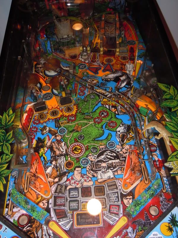

i am having two issues with the JP right now though:
1) the lower right flipper just bailed on me this morning. i played it all night last night with no flipper issues whatsoever...then, all of a sudden, it just goes out. 9 times out of 10, it won't respond at all...that 10th time it makes a halfhearted effort to move but will hardly move with enough force to even nudge the ball.
2) for whatever reason, the damn control room won't start the modes. it has been a while since i played a JP before this one, but if i remember correctly, once you shoot it into the power shed the control room becomes active and will start one of the 11 or so modes.....even after hitting the power shed, my shots into the control room just move over to the bunker and it kicks it up. that's it.

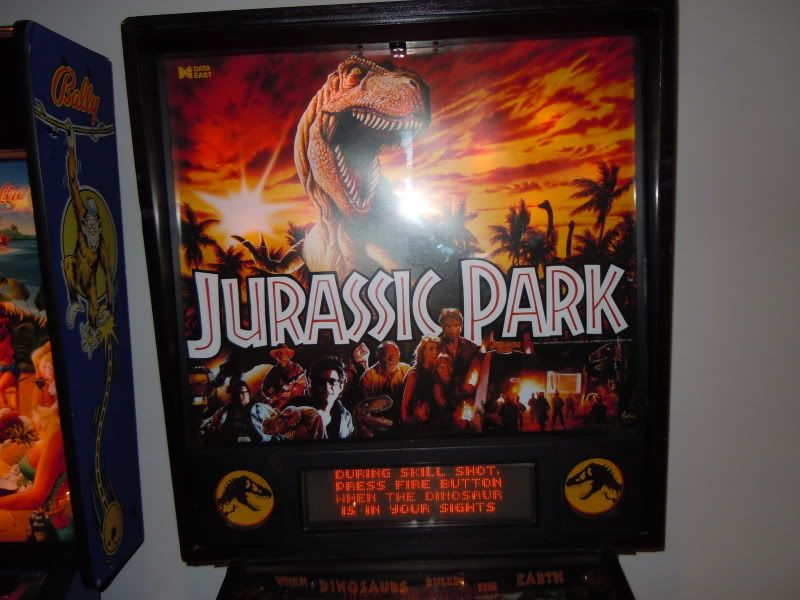

The glass looks correct to me, what are you referring to?
the glass over the playfield....looks like those stickers that were on an older pin. i was thinking of lost world, but could be wrong.
i've never seen anything like that on a JP.

well, figured out the flipper problem....EOS switch had had it. bottom piece was never making contact after initial hit....matter of fact, it actually broke off in my hands it was so worn.
still not 100% sure about the control room problem....i think the rollover switch is bad. i tried to search for one online...i have no idea where to find one.
That glass comes from "Escape From The Lost World", and I believe those are actually worth a good bit of coin.
Whatever the case, it works very well on the Jurassic Park.

Issue #1 look for service bulletin #53. If the EOS switches are not making contact then the flipper only uses the lower hold voltage to try and move the flipper.
Issue #2: look for service bulletin #43. Most likely culprit is a broken diode on the switch for the control room.

You can short out the EOS Switch until you can get a new one and the flipper will work fine, it just will not have the "hold power" that the EOS provides.
No, you do not have to replace the switch (as long as it works) just the diode that is associated with that switch in the switch matrix. If the diode is broken, the switch (even if it works) will not be read. This is a very common problem with JP's (both of mine have had that problem)
