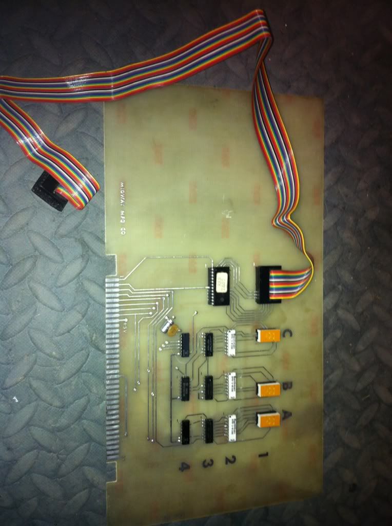

This is the Midway 8080 ram test board for Space Invaders, Gunfight, and Seawolf. It's mentioned in Midway trouble shooting manuals, but this is the first and only one I've actually seen.
Now, does anyone have instructions for this? I know the basics, of how to plug it in, etc, but I don't know what to expect to see in the segmented displays.
That's cool. I read about it in the "Standardized" test procedure document, but didn't know wtf they were talking about. Now I know.
That's very cool, it's also interesting that they made the board so huge with a tiny layout centered. Do you think it fit in a test fixture or standardized rack of some sort?
I haven't tested it, so I don't know if it works. If not, it should be a piece of cake to fix. I'd really like to see some documentation for it.
This attaches to the large main board in place of the smaller board in the "L" shaped Midway 8080 board sets. Then the ribbon cable attaches to the Rom socket in position "H".

this looks like just a rom chip, and then uses the I/O to display values on the led displays... was the rom ever dumped?
Would make a lot more sense to do a plug-in for the 8080 socket than use the original tester -- that requires a LOT of the board to be working before the tests can run.
