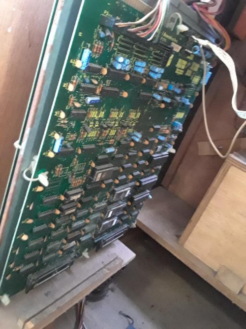

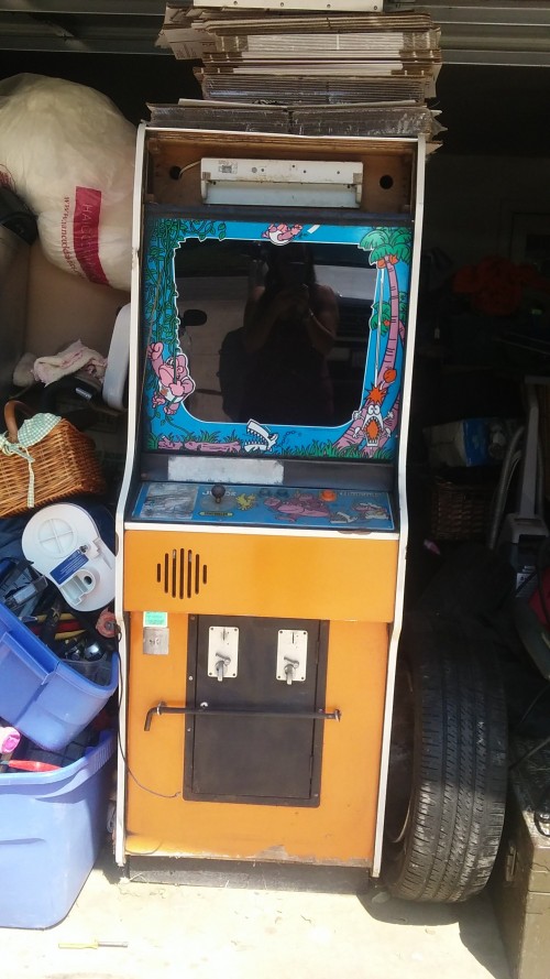

So I was contacted as I stated in my original thread, and after some back and forth untill 1am on a friday night... We came to the $75 price and I rented a truck and drove almost 300 miles round trip to snag this dkjr orange cab.
I was sent these pics:

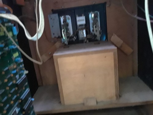

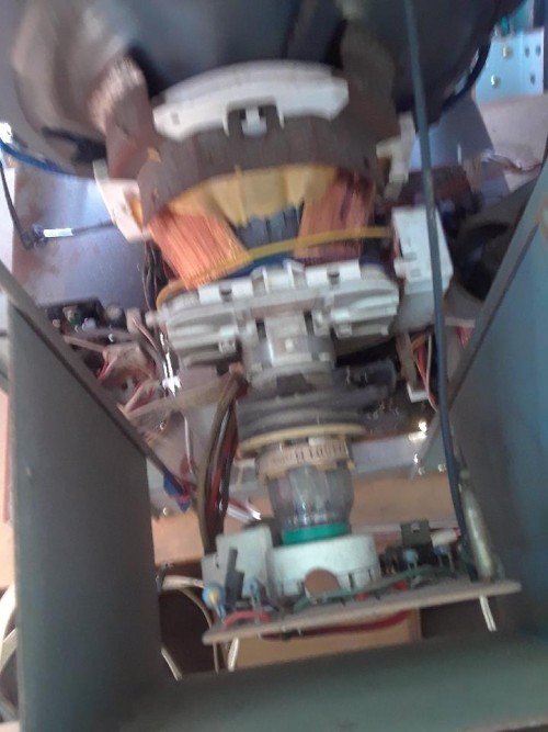

So to be honest... The cab has a bit of flaking, general mis-storage and was garage kept for like 10 years...
It was missing the transformer assembly, I found a gteat klover (insert name) who helped me out with some parts he had stashed away. Unbelievably great guy.
I recapped the pp-7b. Im not sure what people mean by they are difficult.... It was a breeze. Only hard part was not stripping screws. Works perfectly now.

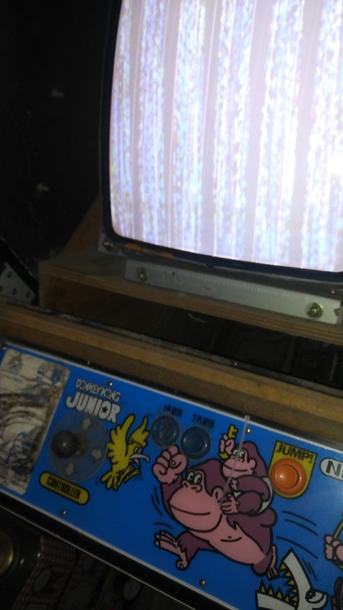

So the original monitor had some issues and something is stuck open. So I pulled a spare sanyo20ezv from my raxk in the garage that had been previously washed and cleaned. I put a cap kit in for the board, b+, and sound board. It was missing thr hv cage and inverter board. Luckly i posted in the wanted sections and I had one here by my day off.
So I pulled the original so I can wash and rack it with a symptom tag. To cap it at a later time, but it will be more than a capkit i fear.
The original boardset looked like this on the monitor

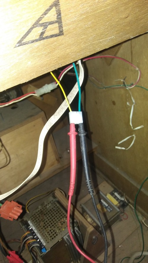

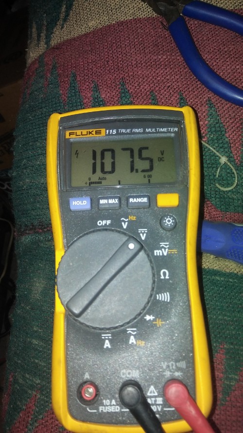

I also installed a remote b+ test point
Worked perfect.
B+ measure safely away from the hv
It looks like hsync is off perhaps the pot on the board? Plus other issues...

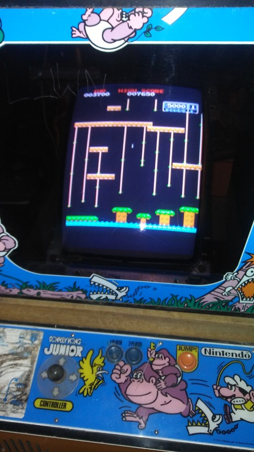

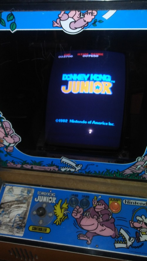

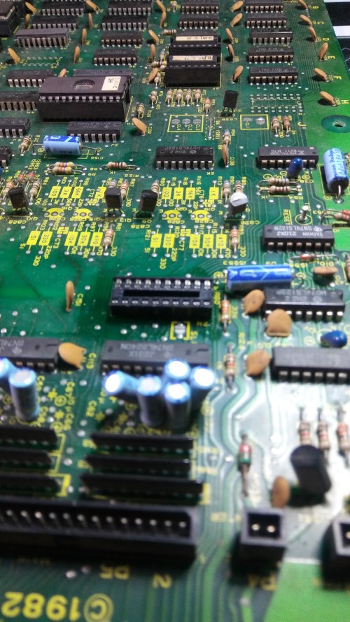

I swapped boardsets to this spare I snagged for $40 which I didnt know at the time had a brazington high score save.
And I got this
And this
Missing sprites.... Wtf. The game plays coins from service... And starts a game... Joystick to the right and rhe missinf sprite hits the water and i lose a life. Untill all gone and it hits game over. Then back to attract.

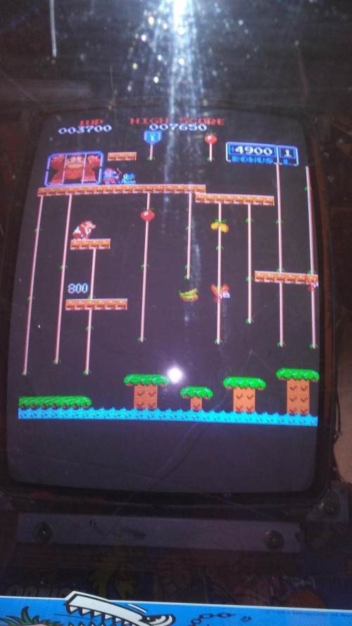

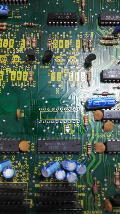

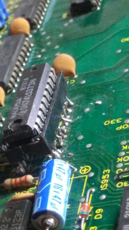

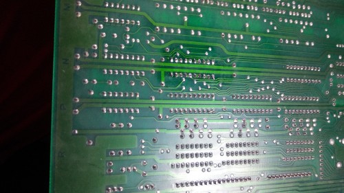

Update so the xhip 74ls373n at 2n was socketed ugly.
Placeholder 2
Look how fugly this chip was socketed. I have an idea who did this, as the galaga boardset was just as knackered.

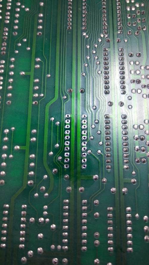

Bad soldering and broken legs. This repair never worked.
I removed the chip
New socket soldered in
We have sprites

Wow that chip repair job... lol... I wonder if they replaced it and were like "why aren't the sprites showing up!?!"
I'm surprised you managed to salvage the solder pads and they didn't just get destroyed by that 3rd grade soldering job previously.
