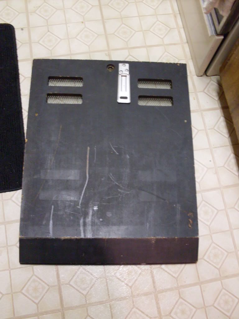

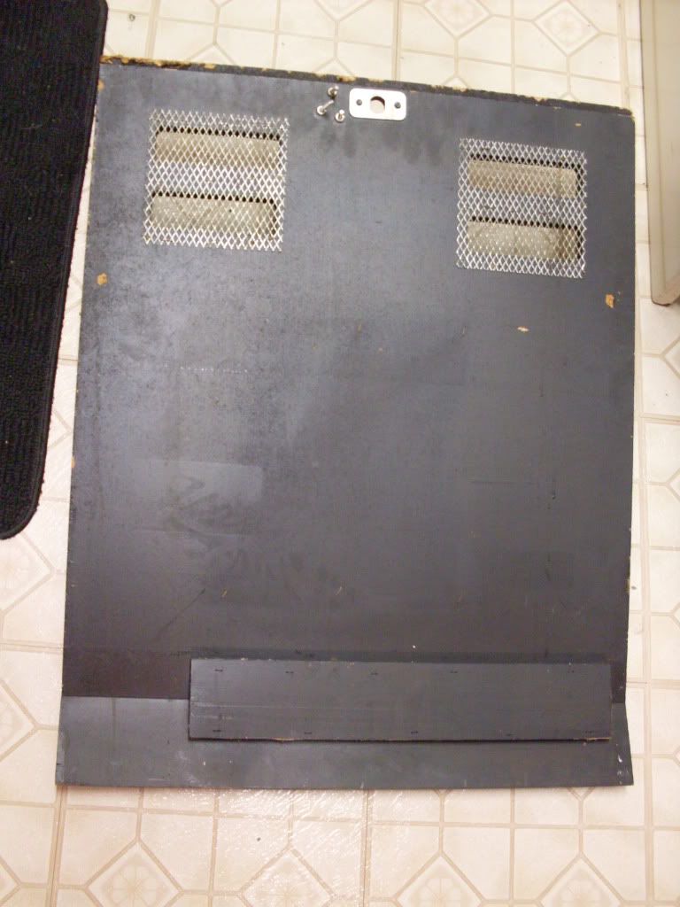

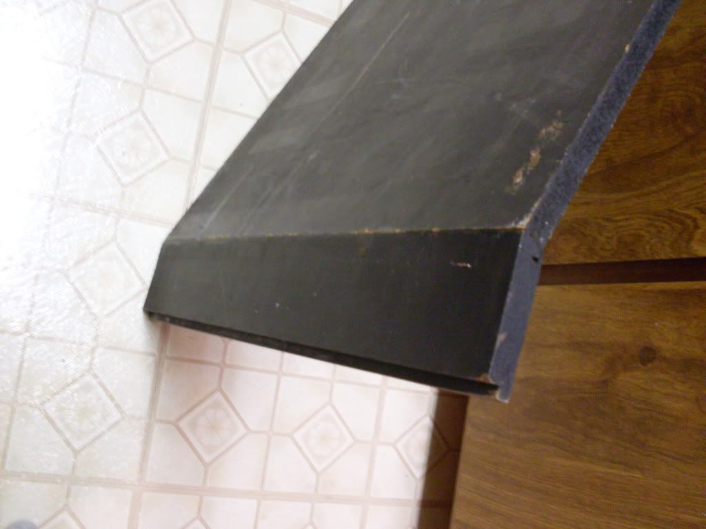

anybody have a pic of the tron back doors?
im particularly interested in how midway contrstucted the angled top door
ANy pics are most appreciated!
thanks fellas!
I don't have the door anymore, but....
I made a few Tron doors this summer. I took a few pics of the process, but can't seem to find them all. I'll keep looking for the others; this one may be helpful in the meantime. I used a 20 degree angle.
My second Tron needs a new back door. I was going to see how well the back door from my first Tron fits the second Tron, then make one on Wed. I can probably draw it up in AutoCad if that would help. Could probably make a few more if anyone local needs one.
