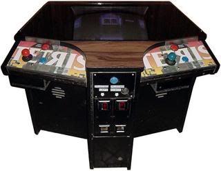

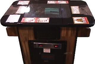

What does the original cabinet look like? mine is in a converted pac-man cabinet lol
