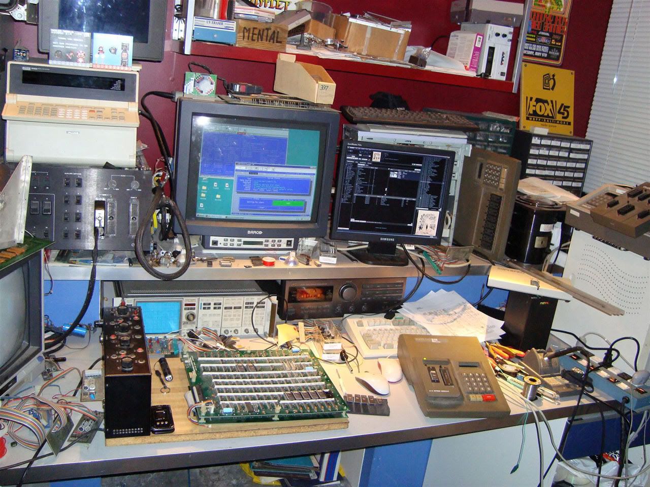

You surely want as much bench space as possible..
I staggered a couple ikea countertops when I put my bench together to try to keep clutter a little more in check. Equipment mostly sits up top and leaves a nice open work area.
Not that it looks like it made much of a difference in this pic:
That eye level shelf right over the test bench is a good idea keeps things in reach and keeps the work space less cluttered. I think I might put one of them up that might solve a few of my issues.

Is that a Jameco burner I see? Wanna sell it? :D
