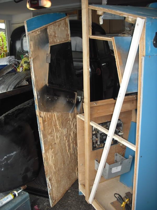

One side of my cabinet was completely infested - the termites had eaten most of the middle layers of the plywood. The outer 1/8" with the original artwork was in good shape but you could basically pull the entire thing apart by hand:
Before I gave up and took it to the exterminators I had tried spraying/pouring different insecticides in there in hopes it would soak into all the termite passages. Once I started pulling the plywood layers apart I found out the stuff I had put in there had only soaked in about 4" from the edges and the termites were happily living deeper in the wood. So I stopped working on it and took it to be professionally treated.
When I got the cab back from the exterminators I pulled more of the wood apart and found lots more dead termites. I ended up trashing the entire side except for the outer 1/8" with the original artwork, which I glued that to a new piece of 5/8" plywood and put the cabinet back together. I also painted all the wood with termite prufe.

Quick update on this. So I purchased the Boracare which seems to have gone on pretty nicely and has dried completely cleanly - you cannot tell it was there. I applied about 3 applications to the inside of the cab... so far I didn't see any more holes but I need to spend a little time filling everything again and then its a waiting game I guess. I asked the exterminators about gas and also about getting them to apply the Boracare themselves and each option was > $250! So for $70, which is still a lot of cash for the chemicals, I did it myself and hopefully that's the end of the little bastards!
