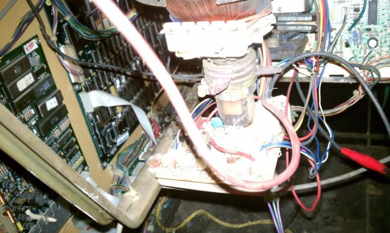

I had the monitor working when i bought it, just flickered a lot (I'm pretty sure the game keeps rebooting itself). I took the board out, put it back in, now it sounds like there power to everything, just no flash/glowing in the bottom of the tube. Just curious what else to check.

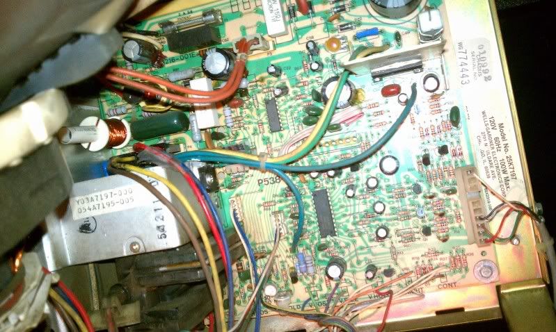

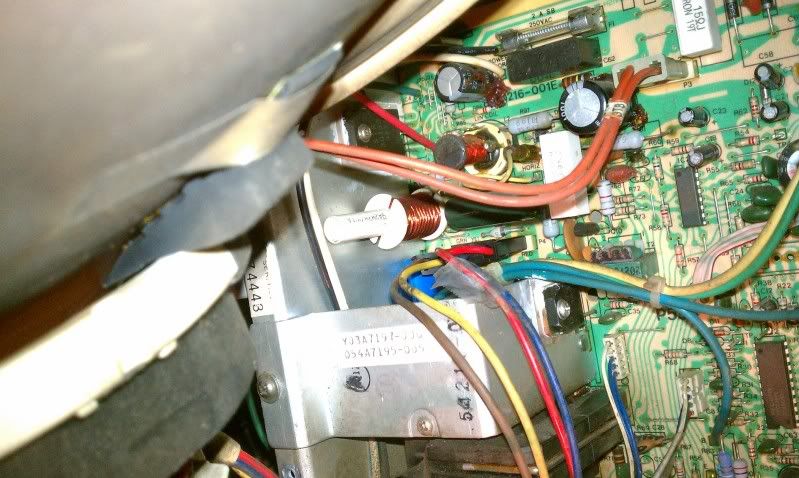

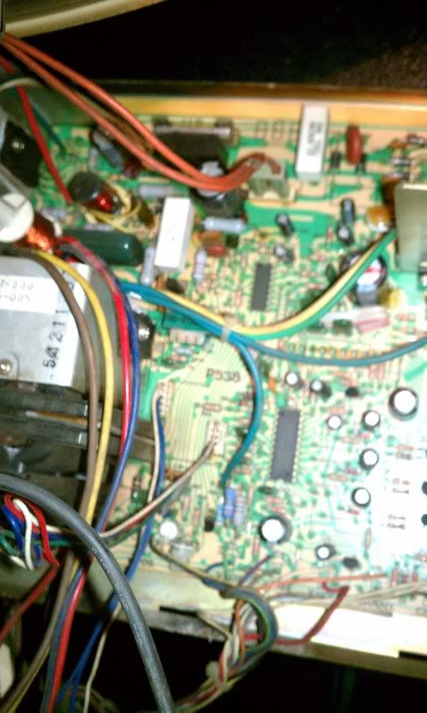

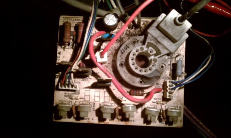

Heres some pics, there pretty piss poor, but maybe they will help?
I just noticed the friggin model number i was looking for, in picture 4
25k7197
Yep. 7197. This monitor is very notorious for having bad solder and traces.
The fuse is in the back. Is it blown?
You could always try replacing C56. :D
Yes, I can fix these with no problems. It's possible your flyback should be replaced, especially if it has white knobs or has little tiny cracks around the adjustment pots...

Fixed his monitor. VR, HOT, and flyback were good, traces looked good (but I touched some up anyway). I thought about just swapping C56 to see if it fixed it :rolleyes: but as I could see C57 domed, I knew that wasn't going to do it.
Threw in the full cap kit and it works. Great pic and colors. Took it to him tonight and put it in, and found his tube is just barely doing red. I didn't have my rejuvenator with me, so I'll go back another day to zap it in.
