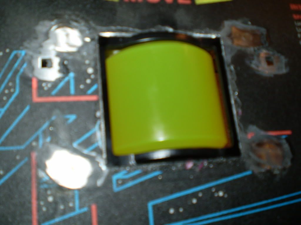

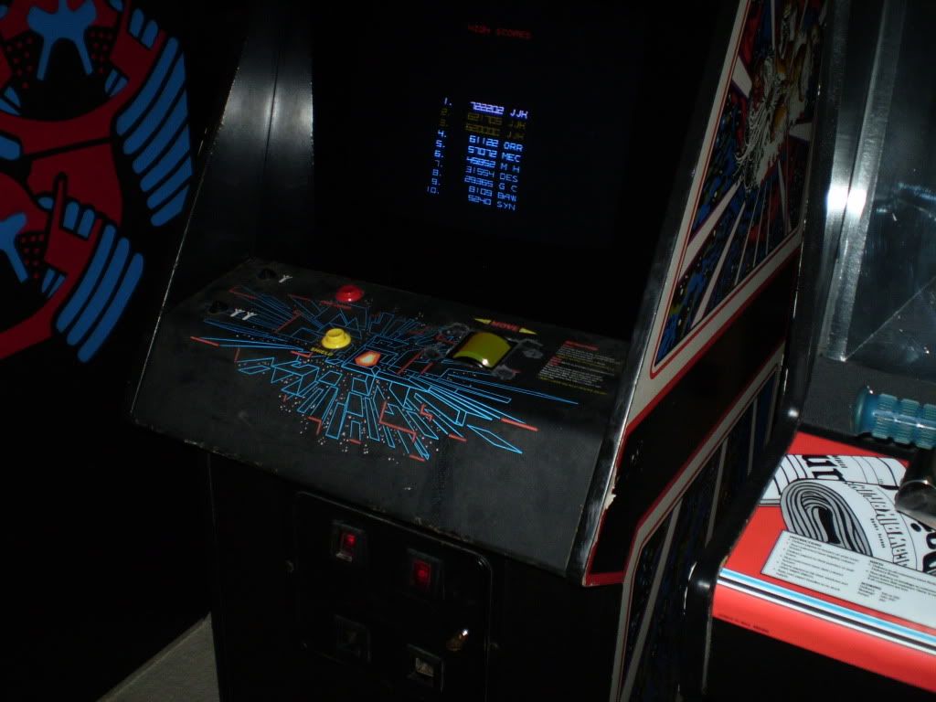

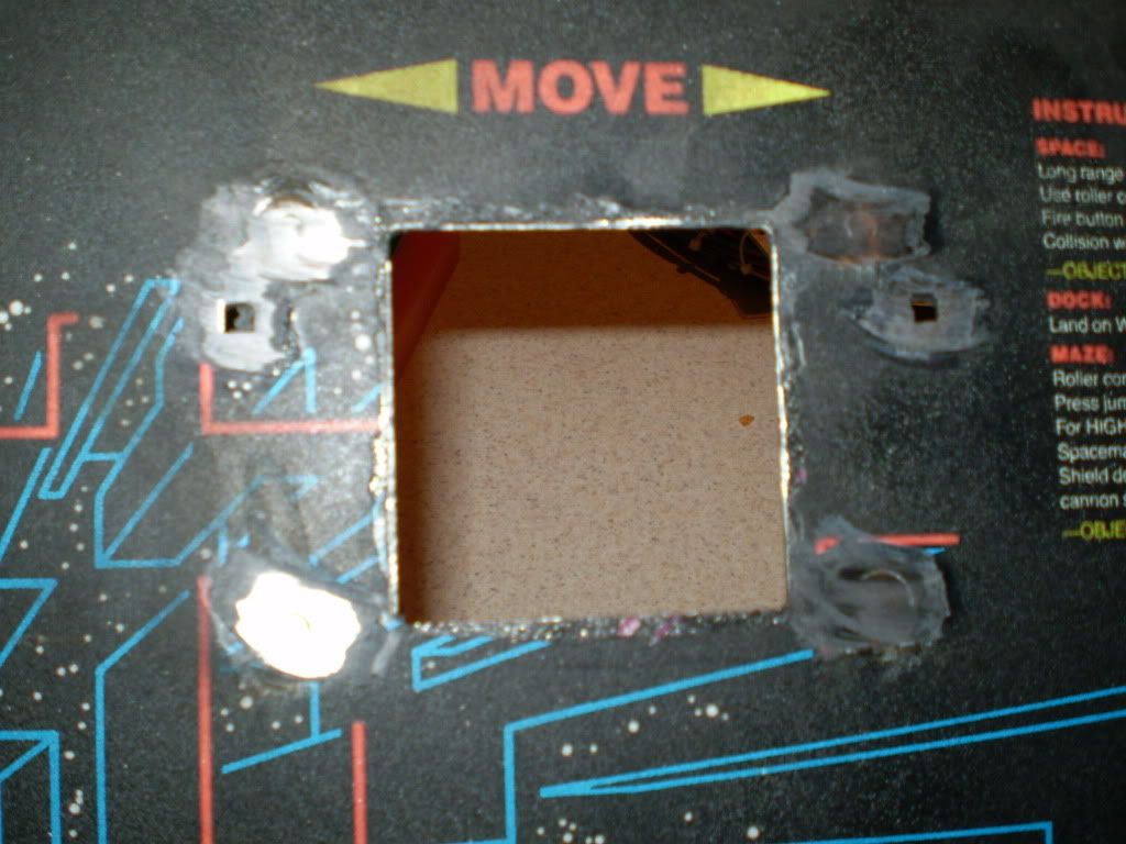

Well, I decided to install a rollerball in a Tempest to Major Havoc Conversion. I like the spinner for Tempest, just wanted to see how a RAM Controls rollerball would feel in this intead.
Spinner CP -

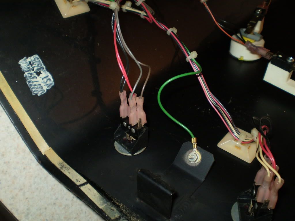

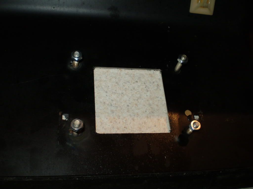

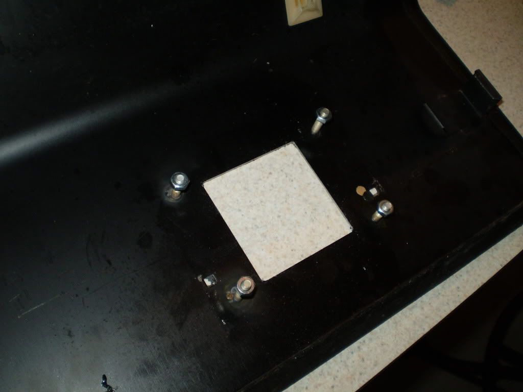

Snapped a few pics of the underside (to remember where everything is). Boy, I hate getting older...
Continued...

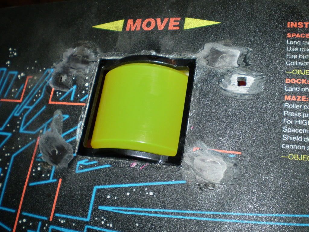

Decided to cut the hole and mount 10/32 bolts to attach (so you cannot see it from the top. Hole was 2.490 x 2.490" to give me a tight fit. I chose 10/32s to give me a little wiggle room to install the rollerball.

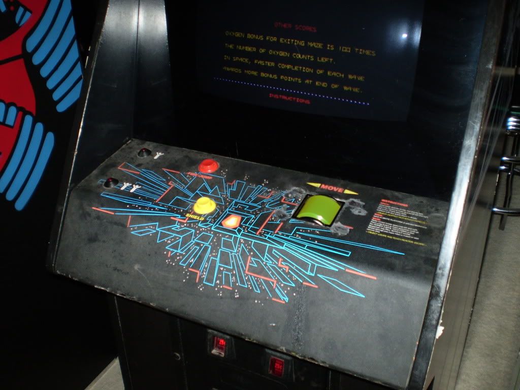

Here is what it turned out -
I left the CPO on for now (have a NOS one to install....maybe, see below)
Continued...
Now, I am going to redo the artwork from thisoldgame.com (thanks Rich!) and powdercoat the metal parts.
The Money shot for now (will get a separate thread once the art goes on)-

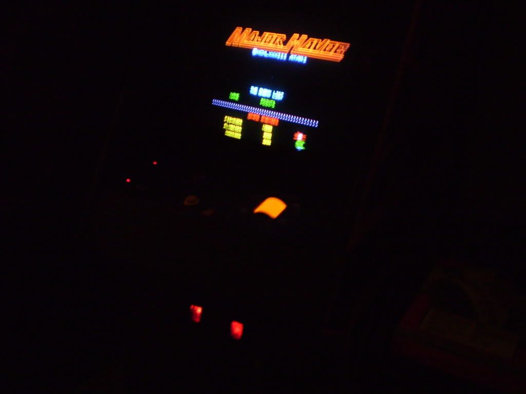

Since the rollerball has a 194 bulb, I elected to use only a piggyback from the coindoor lights. Gives a good glow, not overpowering... :D

The roller works great, plugged right in, no mods needed.

I was wondering why all of a sudden I was getting a ton of emails about the Major Havoc roller. I sell maybe four a month with just as many emails asking about them, but I've hit maybe 50 emails since this thread got going. Sheesh, like I don't already have too much to do. :)
BTW, like that panel with the hidden studs. Nice! Were those welded in or are the press-fit PEMs? I've never had good luck press-fitting PEMs into smaller gauge sheet metal. I think the cut-off for a good repeatable fastener insertion has been around 12GA for me, but I can work miracles when I have to.

Thanks for the props on the hidden studs. It is going to be the best in the long run. I did not want the bolt tops to be seen (or felt) while using the roller.
I ended up welding them in. You're right, pressing is a pain on 14GA.
Now to figure out if Darrin will make a MH CPO that is not die cut so I do not have the spinner bolt pattern (where is used to be) exposed. That would be perfect!

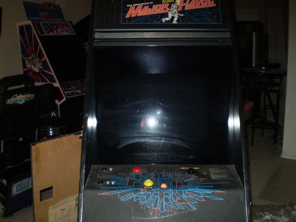

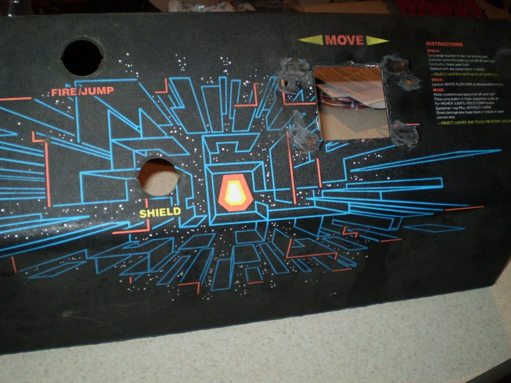

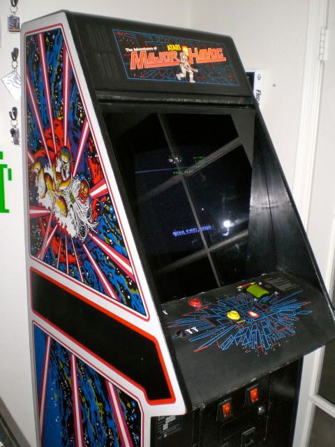

Here are a few pics of mine...

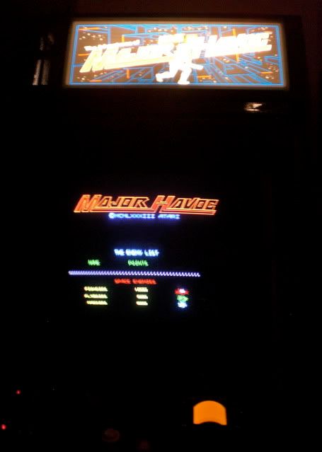

My original marquee was very faded. I picked up an NOS overlay from Nash (thanks!), stripped the old one off (pain in the ass), repainted the wood and grill, and put the new one on:
Here's the game post-conversion, less the side art (next weekend's project???). The lines on the monitor are just the reflection of the doors to my game room:
And finally, here's a pic with the lights off:
