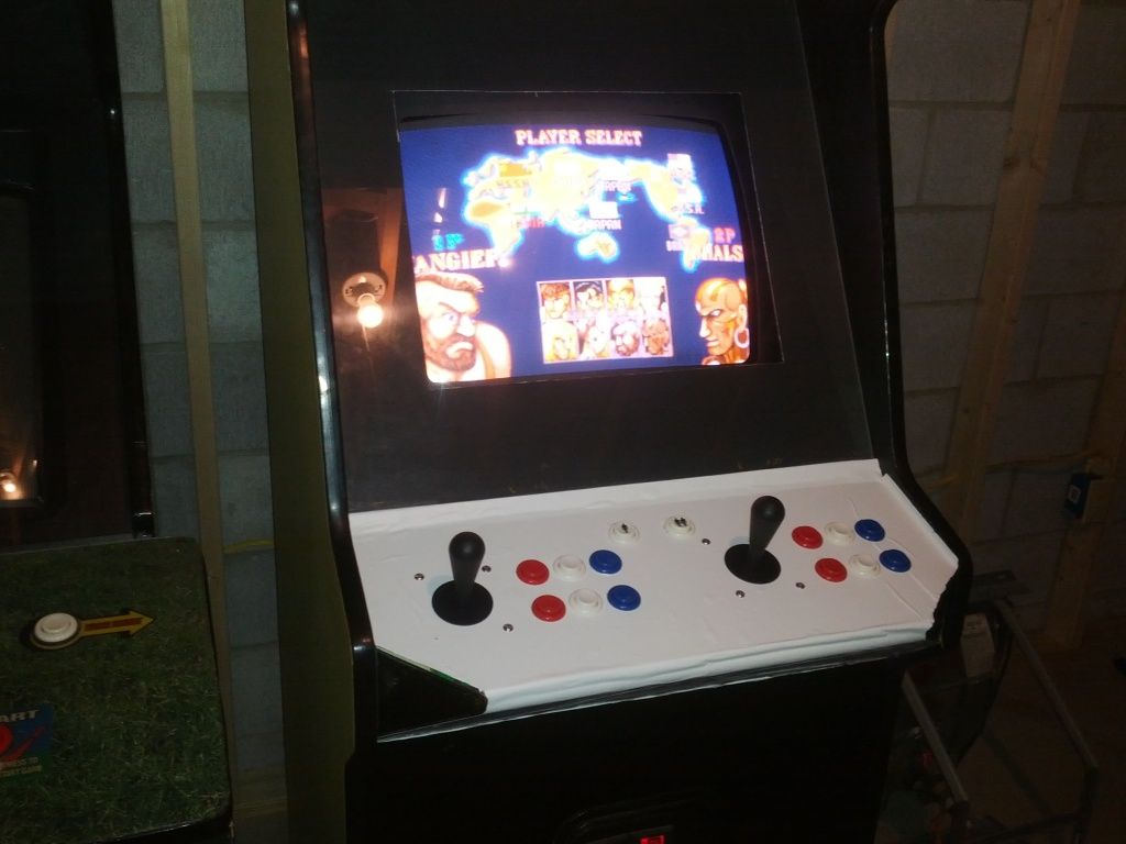

Well here was my attempt this evening...
Wanted to make my street fighter 2 playable...
Found all white contact paper at target ( it was either white or faux marble)
Put on 2 layers and put it all together...
Its playable but it isnt visually appealing...
I'm honestly debating on leaving it as is until I find as actual sf2 cut corner CP. This was my first attempt at modifying a metal control panel and I wish it was better. I don't think this one deserves an actual SF2 CPO...
Anyway here is a pic and honestly this pic does it justice... As you can see, the contact paper is so flimsy that I couldn't get it without wrinkles in a few spots. I also need to trim the edges up better...

I'm still gonna say you should pull off the contact paper and whatever is under it (looks like some of an old overlay) and properly sand and prep the panel and paint it black.
