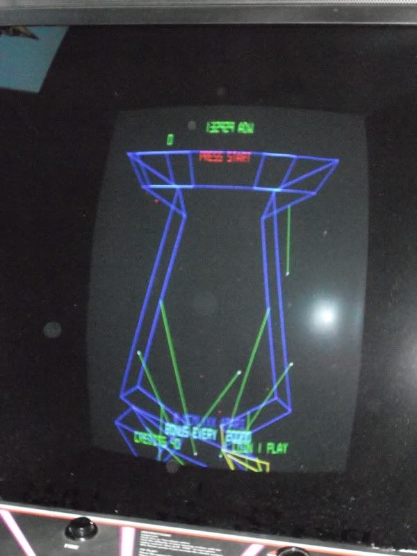

Well, my Tempest (since the day I got it) has had a strange quirk. Hopefully someone can drop some knowledge on what might be the issue.
It has a monitor that's been refurbished within the last 18 months (right before I got it) by arcadecup in green bay, WI... but I'm doubting it's the monitor here.

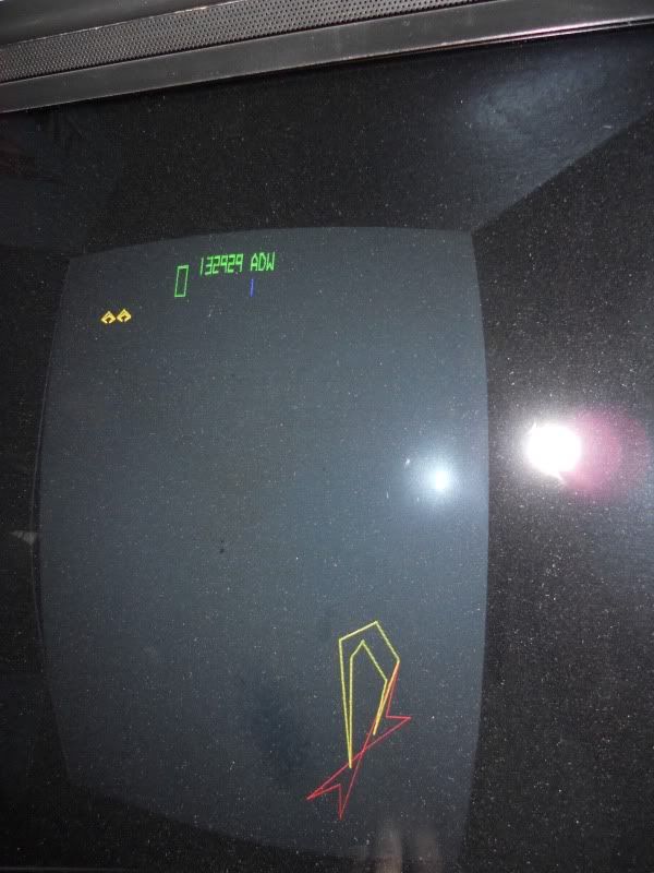

The game will fire up fine and play perfect for maybe 5-20 minutes. Then, during game play screens everything will lose perspective. Like, the shooter/enemies/framework of the tube will just go crazy and sizes will be all over the place. The monitor's 'sound' changes as well. During this time, game sounds continue, and gameplay does too, though you can't really see what you're doing.
Once your game is over, the high score screen and the TEMPEST title screen are just fine & the monitor 'sounds' fine during these. But during the simulated play in attract mode, it goes back to being all messed up looking.
The monitor also gets an overall pulsing flicker as well. Certain elements remain just fine, even when the game goes goofy, like the score.
It goes goofy at random.. there's nothing that seemingly triggers it. Sometimes it'll just happen when the game is running in attract mode, sometimes in the middle of a game.

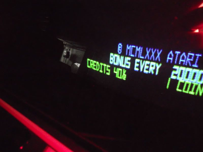

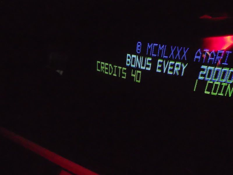

Another curious anomaly is if you power down the game, it will take multiple power-ups to get it to come on correctly...sometimes I let it sit for awhile and then at times it comes back on normal... BUT, during the times when I power it on and it's still goofy, it shows 40 1/2 credits...
But once it runs through the high score/title screen and does a round of goofy looking attract play, it shows 40 credits.
So, is this a board issue? Something with the voltage? I'm relatively new to this, so any help would be appreciated.

The graphics problems are due to the aux board.
If it happens after warm up I would suspect loose alu chips or proms on the board. Can also be caused by poor connection with the interconnect cable.
Easy fixes are to reflow the interconnect headers on the main and aux board. Reseat the alu's pokeys, and proms on the aux board.
I agree with the others. Looks like a math box error. But it could be the cable between the boards. Mine had the same problem and it turned out one of the pins on the aux board had a cold solder joint (intermittent) connection.

I wouldn't 100% trust what test mode says. A monitor won't display things like 40 1/2 credits on its own...that has to be coming from the board. I would check both the aux and main boards for cold solder on the pins that interconnect them as Maxstang mentioned.

So I refloated the solder on all the cable pins for both boards, prayed to the Arcade Gods and plugged my board back into the harness and fired up my Tempest........Yahoo!!!! It worked. The screen is solid, the coin mechs are working, 40 and half credits disappeared and the spot killer was gone.
