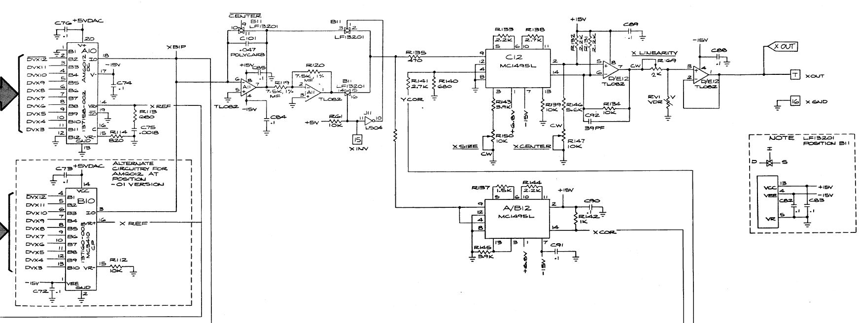

Tempest Plays Blind - But No VG Output At All

I would also put the scope in XY mode on both pin 7's of the first TL082's after the DACs, and see if you can get an image. (As normally you should get an image there, it'll just be scaled slightly from the final output size.) That will tell you if the issue is downstream, or if you're getting the same bad image as when you probe XOUT and YOUT.

That's why you want to look at what's happening at those pin 7's of the first TL082's after the DAC's (because you can't look at the DAC outputs directly because they are current signals, so that's the first place you can see a voltage). You might have something different there than at the XOUT/YOUT pins, because there's other stuff between them. So that will narrow it down a bit.
It's also possible you could just have two bad DACs. I've had it happen. So you could also try socketing and replacing one of them, and seeing if that changes things.
Also, tone out all connections in the video section, and be especially suspect if there are traces of any prior work. Make sure all of the DAC connections and power are actually connected to what they should be connected to.

In any case, the DACs seem to be producing something but probably garbage while in gameplay/attract mode:
But not be doing anything in test mode, when booted to test mode. When you swap from gameplay to test, it does produce random? Noise on the DACs.

What should I be poking at next? Whatever it is seems to be upstream of the analog section. Dacs or above? I do see some activity on the DACs with the logic probe, and activity on the vector rom/ram.

Your VG just isn't working. What you're seeing on the DAC's is just junk, and doesn't resemble anything close to working. You just have to troubleshoot the VG, which there is no straightforward process for.

IMO, seeing that the catbox is passing rom and ram, you do not need to do a signature analysis. You need to go and do the tests for the vector generator, starting with the HALT test, and continuing down the other tests until you find one that doesn't have the correct times. If all that looks good, you can put the catbox away, start looking at other vector areas with a scope.
Then use the digital scope to look at the DAC inputs. Seeing is believing.
Then use the analog scope to work "backwards" from the X/Y outputs though the amps etc and see if any are faulty. Use Y-T mode and not X-Y.

For example, bad DAC. Bad TL082 amp(s). Bad LF13201 switch. Bad MC1495 multiplier. Bad POT(s).

Yeah, I think it's upstream of the DACs whatever it is. Definitely not a DAC or TL82 issue.

I'm basing that conclusion on scope... Plus I socketed the DAC and TL082s in the X section and verified no behavior change with new chips.
So, after replacing the DAC and TL082, there is no waveform at all at the first TL082 stage output A11 (pin1, 7) after the DAC? Even if the DAC has some data on its inputs?

Nada. At least, not last time I checked. Forgot to update on that earlier in the post.

just to make sure you have data going into dac but nothing coming out. You of course have verified proper input voltages to dac and tl082
