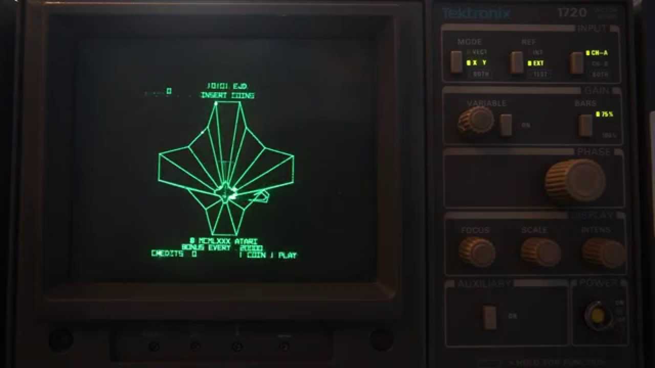

Well, now you have other issues ... once fixed then you can test the final output by doing the following ...
You have scope? Hallelujah. :)
What type? Analog or digital? Know how to use it? Need two probes - one for XOUT, one for YOUT.
Disconnect monitor plug. Put probes on XOUT and YOUT test points on logic board.
X or Y look similar to:
XY mode - you'll see the game (if working correctly). Don't be concerned with the trace lines.
pulled the vector Generator Rom at R3 again, and now the X and Y don't have the DC as listed in my last post.

Connected and looking good on a scope.
Now what?
it appears to be playing fine and going through the test modes. I think I have a bad or several bad rom sockets. I am getting intermittent issues in that area. The fire button also seems to be stuck

What voltage settings is your o scope on to get the waveform for x and Y out in the image prior to seeing the game play

Yes, those voltages are high and will cause damage. They weren't there the whole time. The x and y out are now back to close to 0. This was a problem with the vector generator ROM. I reseated it and it's back to normal. The question I have is, if I am able to see the game on my scope in x/y mode, does that mean the board is fine and I need to look more into the monitor. The board ROMs are sketchy. At a minimum I need to replace a few ROM sockets and possibly a few ROMS. It's hard for me to know if this is a monitor problem or ROM problem when I know the image on the scope is intermittent due to ROM sockets.
You can try this.
1. keep scope connected to confirm good X/Y outputs
2. connect the monitor
3. confirm no spot killer
If you still get spot killer when scope is showing vectors, then you know the deflection board has issues.
Ideally, if you suspect the sockets are bad on the logic board, you need to resolve that. (I assume you've also resoldered the interconnect cable)

One thing that has bitten me a couple times with using a scope for Atari vectors is that a scope is by nature much more tolerant of offset voltages than a 6100. Which is to say, you can adjust the XY size and position pots on the board such that they're generating an image which the scope will show just fine, but the 6100 will not. Simply having maladjusted size/position pots can produce the exact effect you're experiencing. I'n not saying this is or is not your problem, but you should rule it out before going deeper, because it's simple and not always obvious.
Power up your PCB in test mode, so you get the crosshatch screen. With your scope in YT mode, connect your channel one ground clip AND PROBE to the X test point. Adjust your scope so the flat line is exactly in the center of the graticule. Leaving the ground clip alone, hook the probe to the X OUT test point, and adjust the X CTR pot so the waveform is centered on the center line of the graticule. Then adjust X SIZE so the peak-peak voltage is no more than +-8v.
Repeat with the Y axis, except max P-P is +-6v, and using Y CTR / Y SIZE pots (obviously).
If all that looks good, hook it up to the 6100 and see what happens. If you can't adjust to stay within the peak-peak voltages, you have an analog video output issue on your PCB. Check the +15 / -15 regulation and swap TL082s, these are the most common issues.

^^ dude, post #7 he shows tempest playing on his scope. Really, scope not useful? LOL :rolleyes:

The scope is a 'nice to have', but leading people to believe they need one to work on these is misleading, as A) most 'average user' folks don't have them, and B) most of the time you don't really need one for these, as a DMM tells you everything you need to know in terms of knowing if it's safe to connect a monitor or not.
A scope also won't tell you if your DC levels are in the danger zone, if you are viewing the signals in AC-coupled mode (which is what you should be doing anyway, just to be safest for the scope).
You can have your X/Y centering pots maxed out, and have the DC levels well in the danger zone, and the scope display will still look fine when you are AC coupled. So I always measure the DC and adjust it with a DMM before connecting the monitor, even when I use my scope as a display.
