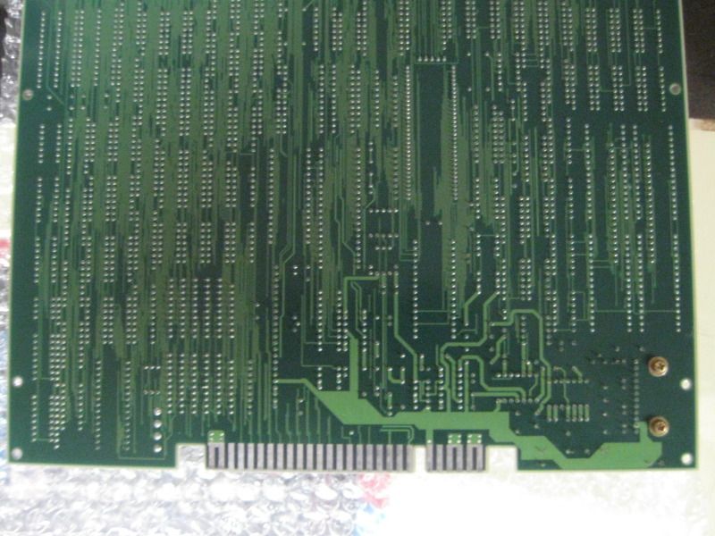

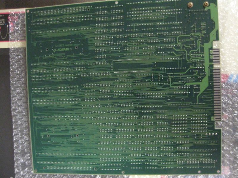

That´s definitely not a monitor problem, you should send pcb to repair, send a hq photo of both sides of pcb if you´ll tackle it to see if there would be anything suspicious.. but if everything is ok, you won´t have no choice..

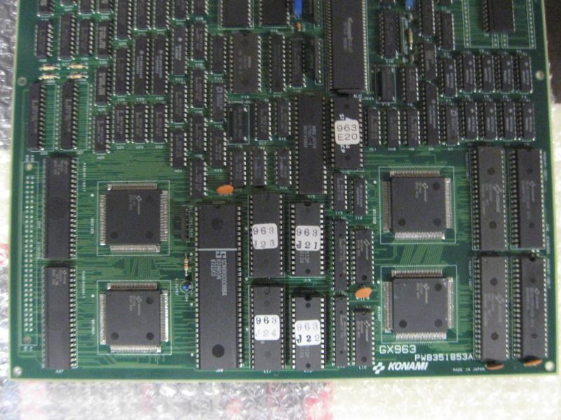

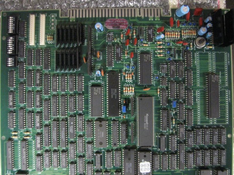

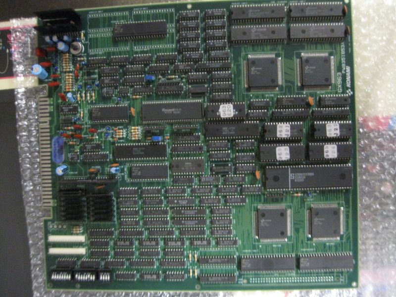

Here's some pics of the TMNT board
I can say categorically that this is not anything to do with caps, or a dirty edge connector. Its going to be either a logic fault, a RAM fault (tho your board has Motorola SRAMs and they are quite robust, the lack of Toshiba TMM201x is a good thing) or possibly a transient fault with the mask ROMs. It also wont have anything to do with socketed chips as the ROMs on this board contain the program code, a fault there and the board would not boot.
Put the board into test mode and get it to do a full RAM ROM test, there's a much more in-depth test than the one it does at boot up. From memory you need to set the 3rd switch on the dipswitch bank 3 (the one with only 4 switches) to ON while it is powered off, then power on.
Sadly these boards are peppered with Fujitsu TTL chips and they are dropping like flies these days, but that's where my money would be.

No such thing as "clock chips leading to RAM chips" I'm afraid. DRAM has the closest to a clock with its CAS and RAS signals but those are a refresh signal, also DRAM is pretty rare on arcade boards from the mid 80s onwards.. SRAM which is by far the most common type of RAM on boards and it doesn't require refresh signals.
Assuming you were not thinking DRAM I am guessing you mean the /WE and /OE pins on the RAM chip which isn't anything to do with a clock signal, but it does synchronize the chip activity to what the rest of the board is doing. Although it is more likely to be a logic fault incorrectly driving the palette SRAMs as the youtube video shows two things. Firstly that the board is doing the right thing most of the time, secondly when it gets it wrong it is very wrong. Therefore my probe would be pointing towards the upper address lines on the two MCM2018 chips middle bottom of the board as per the first photo.
From very very faint memory the address lines are fed by a load of 74LS157 chips, I would guess (and it is a guess) that you have one that has a weak output, on pin 4, 7, 9 or 12. Fujitsu 157s are the worst of a bad bunch I have found, so many faults on so many boards. Have even had a TMNT board that was running in black and white once as a result of multiple faults
