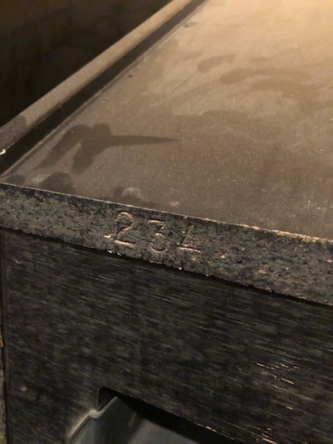

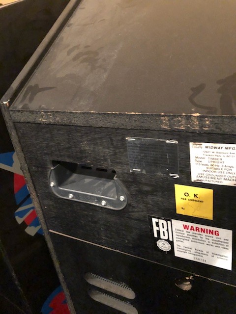

Here is a picture of the back of my Timber which was originally Tapper#3283 (defaced) and a new serial number applied for Timber #234

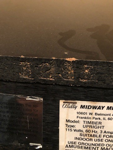

Close up of the defaced or eradicated Tapper serial number on my Timber
Close up of the new Timber serial number stamped into the cab
Also apparent in both of those photos is the Bally Midway tag stapled to the back of the both of the cabs noting the game.

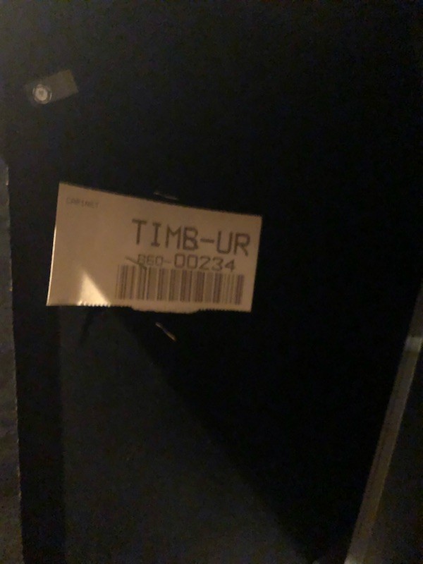

Pics of the inside ID tag on my Timber

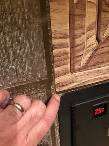

The Timber sign/logo on the front of the game is also applied over the original Tapper art at the factory. Simply a decal/sticker thats applied on the cab.
