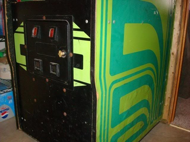

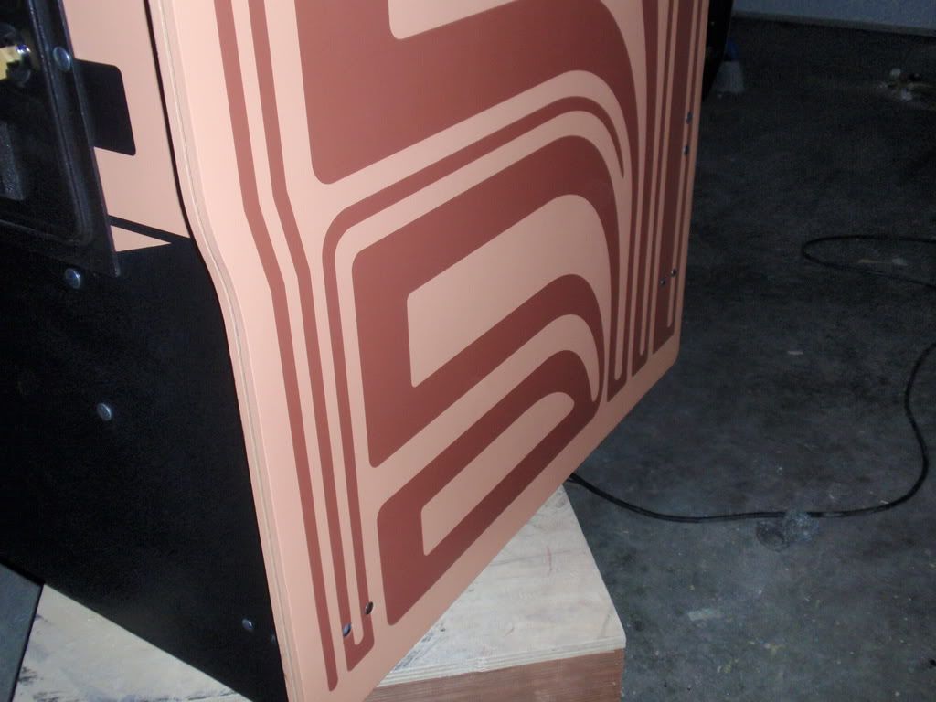

I like bringing them back from the dead. I used the square method on this one to make sure the sides were pretty flush and level. It worked.

Re: Taito Stenciling Project-Elevator Action "Rest
It wasn't damaged, just blemished. The blemishes are gone, and the integrity of the cab is still there. Don't give me that patronizing 'if you're happy' BS. The cab is in great shape now. My happiness does not play a factor. It simply is what it is. Now good day to you sir. (And don't forget to set aside that light fixture for me, my esteemed friend Shar.)

Wow. Nice work again. It seems you're running a one-man factory line there. Is this "zen work" for you?
My Galaga has a ski-slope looking taper on the bottom 8 inches on both sides due to water swelling damage. I've been perplexed as to how I can sand it down level again, but I don't know how to do that short of disassembly and running them through a wood planer. Perhaps I will try your method.
Oh, and you still haven't migrated to a sprayer yet, the finish looks great for a roll-job.
Yeah it worked well. Here is a better before and after comparison pic of the repaired swelling:

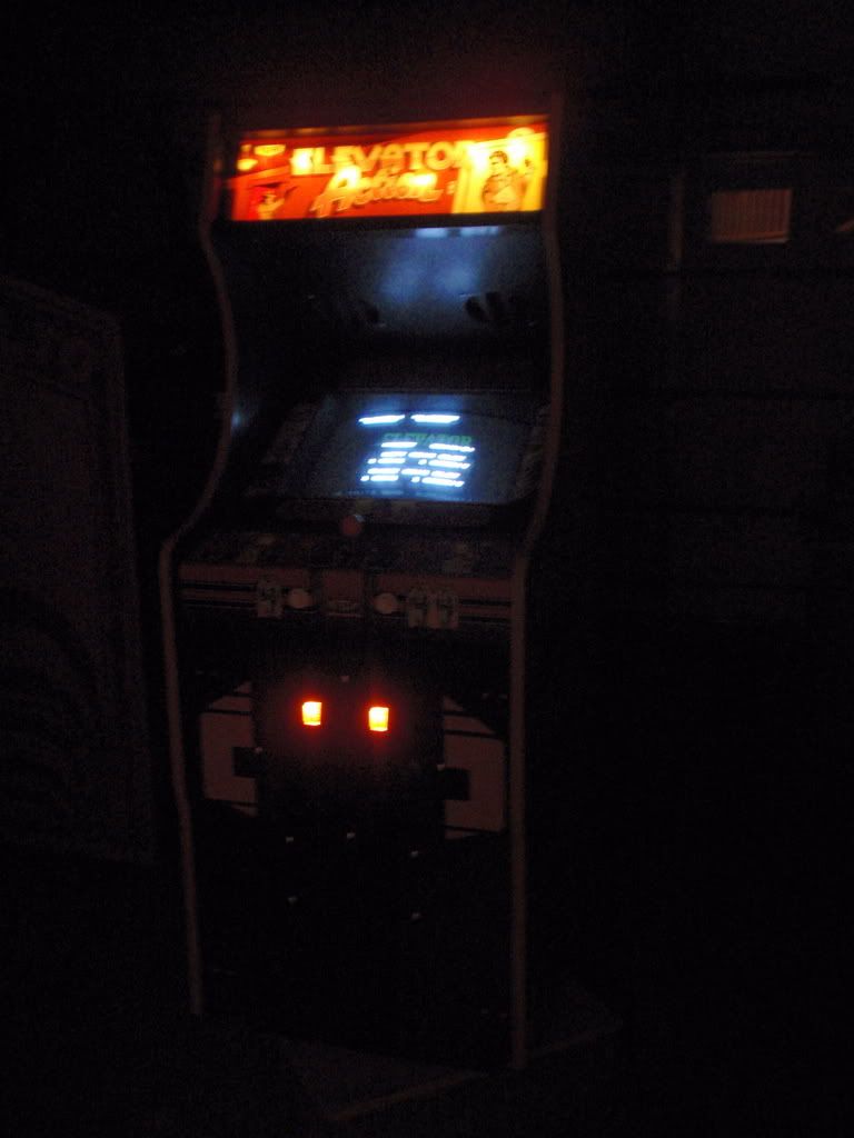

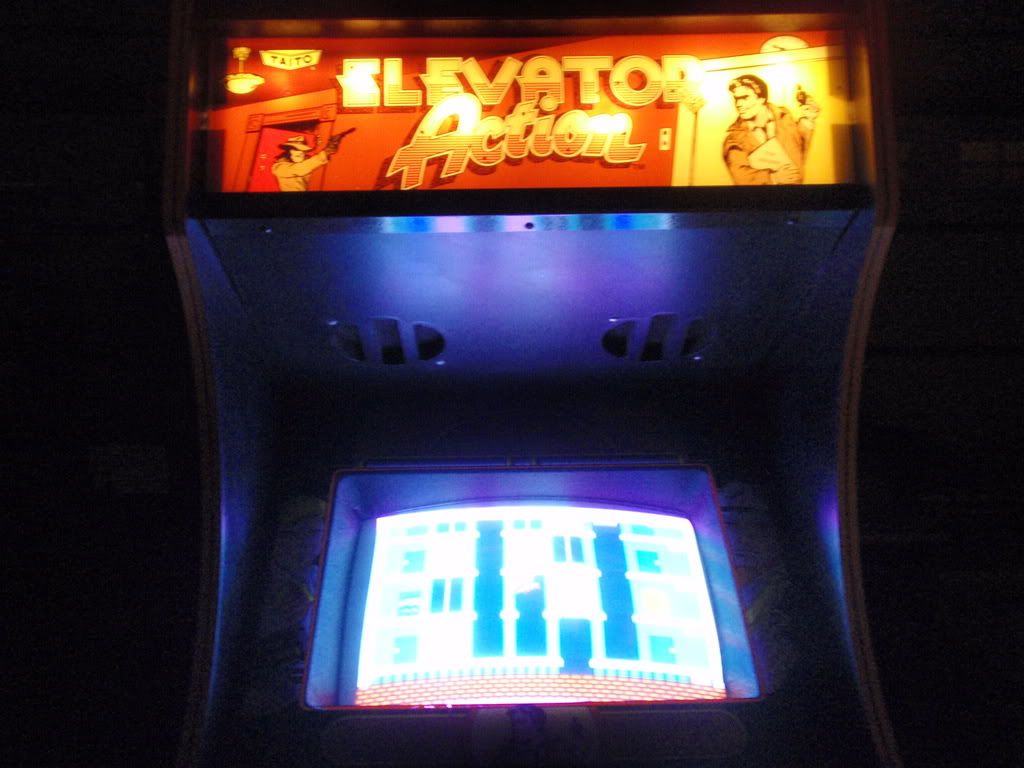

BTB, 3 pieces of T-molding and an in-line fuse holder and she's done:
New monitor?
And why is that nintendo cab upside down?
New monitor?
Recapped used monitor, very little burn
I built a new base for it and I wanted to let gravity pull some glue into the bottom of the somewhat frayed cab sides. Ever tried to shoot glue upward?

When you sanded that cab..did you have any issues with peeling of the old artwork from the MDF..or what method did you use..that would be my concern in sanding..since it doesn't act like wood..??
It's a painted stencil. I used 80 grit, then wood hardener, then 120 and 220 grits. After that I primed it and it was solid and smooth. Best part is, since I sanded away the mountains rather than filled in the valleys, all that remains is solid MDF, rather than 30% bondo.

is it just me or is the shaft on that joystick too long?
Yeah, it's a standard 3.5" Wico. That's what the game had on it, and I like a longer shaft. If the new owner prefers the original shorter one he can always replace it.
