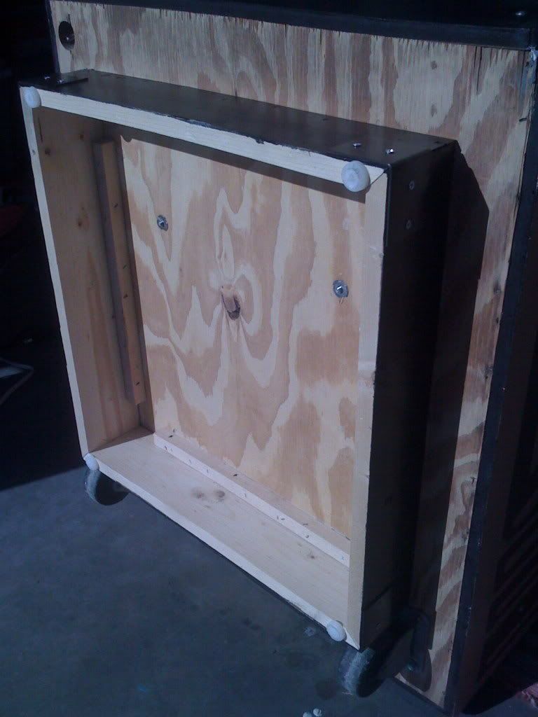

The original Taito cab bases WERE made out of plywood:
The delamination and layer flaking are the suck. I rebuilt mine using mitered 1x4's:
Then I put the small nail on teflon chair leg sliders on the bottom to save the wood from future sliding:

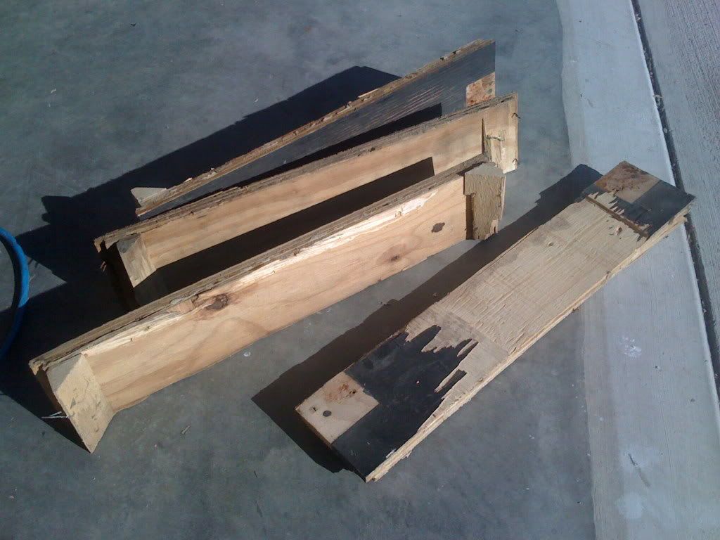

Got pics? I have had 3 Taito cabs in the shop, all with plywood bases. Not that I don't believe you, but it seems strange to me. MDF is a horrible choice for cabs in general, but for the base? Yowsa. Even good old Qbert, which is an MDF cab, has huge wooden runners underneath the cab for its base.

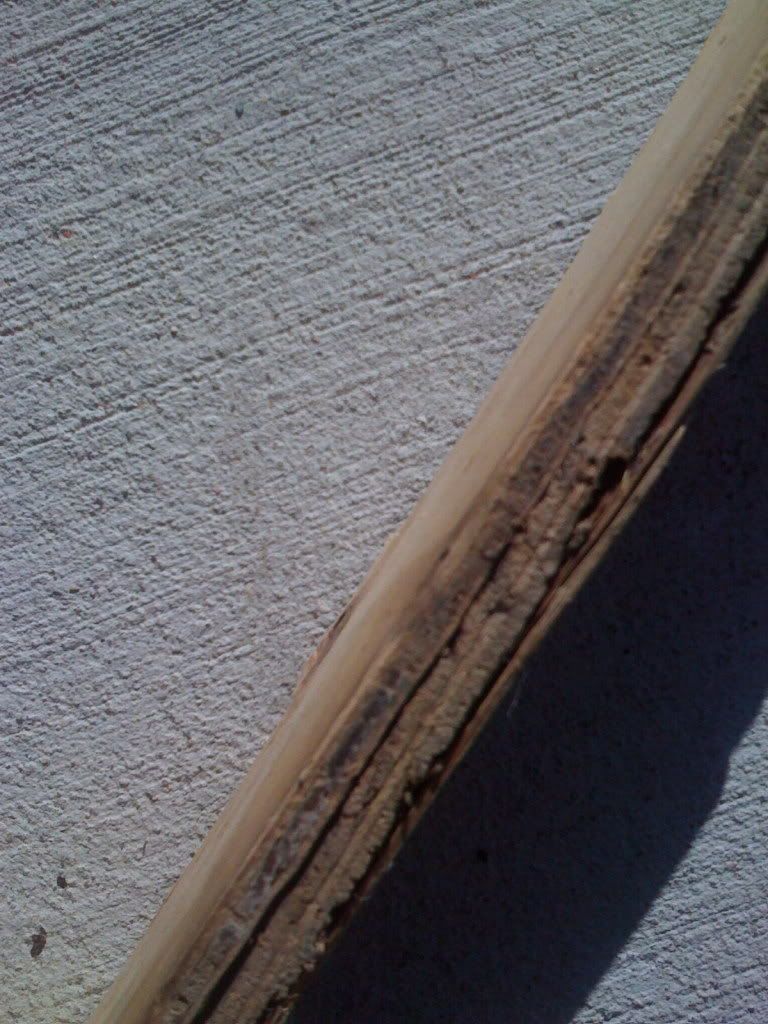

Here's are pics of the base pieces. The swelling is pretty bad.
I agree; MDF is a really bad choice for a cabinet base :mad:
