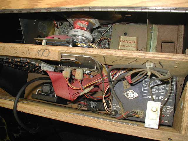

Don't laugh, but I plan to restore this beauty. Any help I can get would be great. I contacted wysiwyg2, and hope to be rebuilding the power supply based on his recommendations. A local collector owns one of these (in a complete cab) and hopefully I'll be able to take measurements.
Besides the missing back half of the cab, I'm missing one of the shield control panels, and the back plexi. The previous owner managed to find the back marquee graphic, so at least I have that.

After replacing the bridge rectifier and the two 13000MFD caps, the power supply has proper and steady voltage. I have one more large capacitor on the 5v side that I'm going to replace when it arrives.
If the monitor is plugged into the harness, the circuit breaker goes after a few seconds. With it not plugged in, it stays on, but doesn't play blind. So that sucks. The main PCB didn't come with an LED, so I guess there's no way of making a quick diagnosis.

After finding some info online this week, I decided to drag this project out and check over a few things. I replaced a few burnt resistors and two or three voltage regulators on the audio board. After that I was able to coin the game up and it's playing blind. It's a huge deal for me to know it's mostly working, since my CCPU doesn't have an LED.
If I have power going to the monitor it trips one, then the other breaker after about 3 seconds. If I unplug the yoke and the CRT socket the breaker never trips. That's as far as I can get with it.
Any advice on where to look next would be great. I have one guide that recommends checking the +5, +15, and -15 regulators. I managed to test the +5 and it's good. The others are just too far down under to reach. I'm considering ordering replacements and swapping them out.
Right now, if I power the game on, I can see a glow on the screen, it seems to flicker a little, then when the breaker trips, it flashes and you can see maybe a line or two drawn for an instant.
