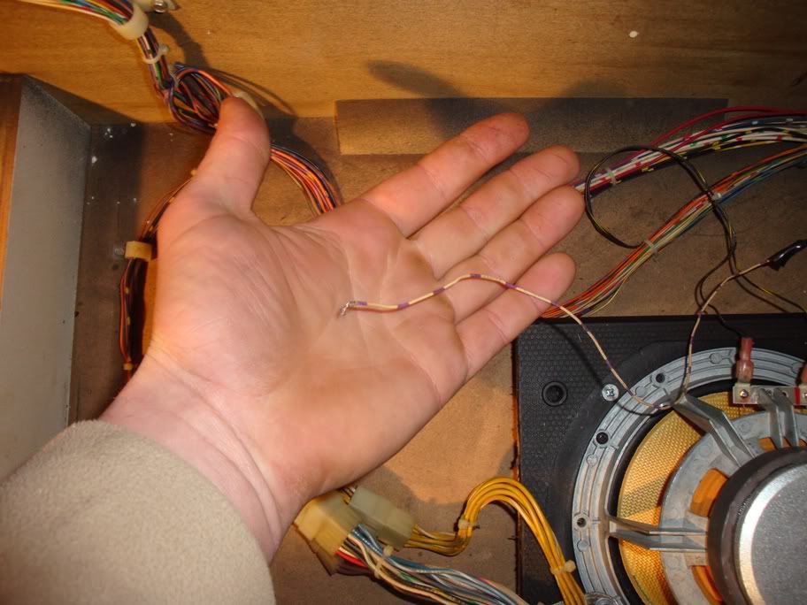

Hey people I am starting whit my game room and got some pinball's from somebody:
d.e. teenage mutant ninja turtles working
d.e. star wars one relay whit bad solder points its fixt
And a bally Addams family, only the problem is one lose wire white-violet from switch row 7 the problem is it's disconnected under the play field does somebody now where its need to be connected? Thanks
I took some pics for you of my Addams

Run it through the test menu and check which switch out of bank 7 doesn't work. That would be the quickest way. Or you could just look to see which switch doesn't have the ground wire attached to the diode side.
It could be the right trough, ball shooter, right slingshot, center swamp million, bumper lane opto, upper right loop, thing kickout, thing eject hole, and possibly things flipper EOS (upper left flipper).

Take a look at J208-8.
The manual lists the color you specified as that location.
The white wire purple stripe in your picture, I noticed the black tape on it. Be sure the wire color is the same on the other side of the tape, otherwise it could go somewhere besides the switch matrix. If high power for instance, you don't want to send that to the CPU.

I explanted it wrong I think so
The part to the back box is oke to the right connector
But it's come lose some where under the play field and I don't now where it must be connected. Directly to one of the switches on the swits row ?

If your game was a re-import, the knockers are usually left out and that transistor used for a meter. If you set the cpu jumpers or switches to American you can add the knocker back in.
If you have a manual, you can easily find the row ( rows are white wires, columns green ) the white wire is on and which switches and from the back of the playfield follow along until you see a spot missing that wire.
Or go into tests, single switch, step through the switches and then hit the start button and then the + or - diagnostic buttons and this will step you through the switch, wire colors, and connector info.
