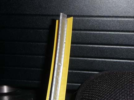

I know this has been mentioned on here already but I did the duct tape method on my SF RUSH T-molding that didn't fit and it worked out nice. Really tight fit.
I ended up doin g2 layers on this to make it work.
Example image
