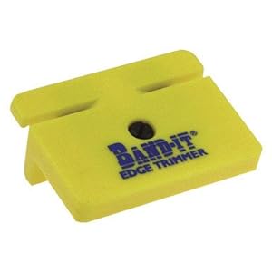

I actually tried a flat, brand new razor blade on the top 3 feet of one side to trim the excess. it worked well, but if you lose your edge and have to start over, you can see the uneven start/stop bump. I am scared shitless to run the razor all the way down the front edges on BOTH sides of the game for fear of making it look worse or catching the wood somewhere.
Lowe's sells these..haven't tried it, but would probably work well-
probably an aisle on the lumber side with the specialty/hobby plywood, they will be with the rolls of edge banding veneer - they probably will have birch and oak. That edge banding is slightly oversized and it's used for that. Not saying it will work, but I don't see why not. The t-molding plastic should cut easier than the wood, but I wonder if the edge banding cutter tools expect to ride against a square edge - like the wood use would be, where you have the flat side of the cabinet, like _____]
or if it will work with t-molding , where you have a edge, like _____)
The real problem is that the size of the king's foot has changed. He was probably wearing more restrictive footwear in the early 80s.
Sorry..I've tried the edge band trimmer. It doesn't have enough cutting power. It's made for wood veneer edging which is much thinner and easier to cut. It will get bogged down in the t-molding. I even tried a commercial version of that kind of trimmer that my neighbor had. No workey.
