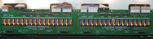

I've been having a problem recently with a System 11
display. It's the right display (the game has the Left and Right 16
character displays) that has a stuck on segment and a partially
working segment. The 'A' segment is stuck on in the middle of the
display, while the 'B' segment only works sometimes. Here is a
picture:
Both should be displaying a 1. The right display only shows a 1 on
some of the digits, and you can see that stuck upper segment. I've
had Rottendog send me a replacement, I've replaced the connector, and
replaced the U51 *I think* and U44 chips that have to do with this
right side. No change. This has been a very frustrating problem, as
the rest of the game works great. Also, you cannot just switch the two displays and see if the problem moves, as the connections are different
