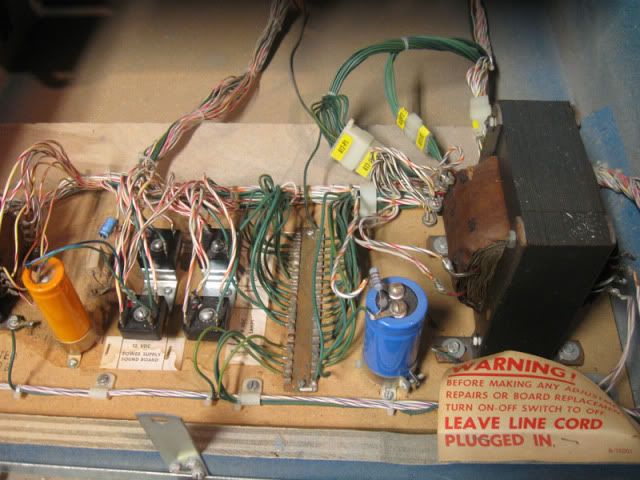

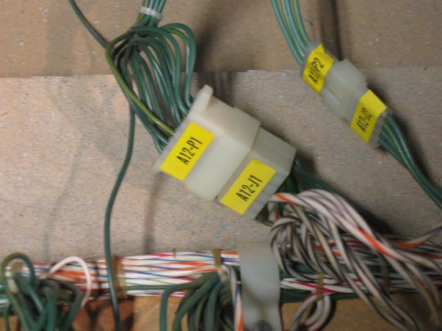

Ok, ALL the backbox mods are done. The only thing is the power supply in the lower cabinet. I've looked at example pictures on pinrepair, etc. and none of them show what looks like this games setup. Here are a couple of pictures:
I assume that the ground goes through those connectors. So what can I do to modify this and ensure the connectors don't cause issues later? Also, I am replacing that Orange Cap as soon as the replacement gets here.
pinrepair.com has a section showing how to deal with that......basically you solder all the ground wires together just before/after the connector plug. By doing that you are tying all the ground wires to every available pin on the connector. In the event one of your pins or connectors takes a crap, there are numerous other paths for ground to travel.
I saw something like that, but what do you really do there? Strip a small section off of each wire, then wrap bare wire around all of them, then solder?
Even then, the connector still is a weak point. I wonder why they didn't just solder direct to the copper strip without any kind of connector at all?
The connector is the weak point -- but if you tie all the wires together than you have several of the contacts running in parallel. Before, if you lost just one contact, you would be hosed. Now you could lose more than one and still be grounded.
Agreed that a direct connect to the ground strip would be best connection. But in doing this, you make it more difficult to remove the cabinet transformer board in one piece or other assemblies. Probably wouldn't matter because most of us never plan on removing these anyways.
Ed
IF I was gonna do this, I'd probably just cut the wires 4-5" from where they enter the plug....strip both ends of the wires...then tie them all back together, soldering them together as I went. Per the photo at pinrepair, it's not a very attractive proposition, so I'd probably have some large heat shrink wrap around to finish things off nicely.
