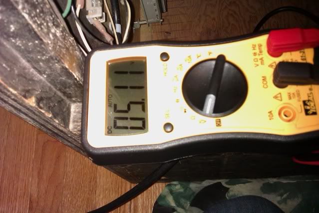

In my JAMMA cabinet, when hooked up like this:
Jamma Harness --> 3' Jamma extension --> PCB
everything works fine

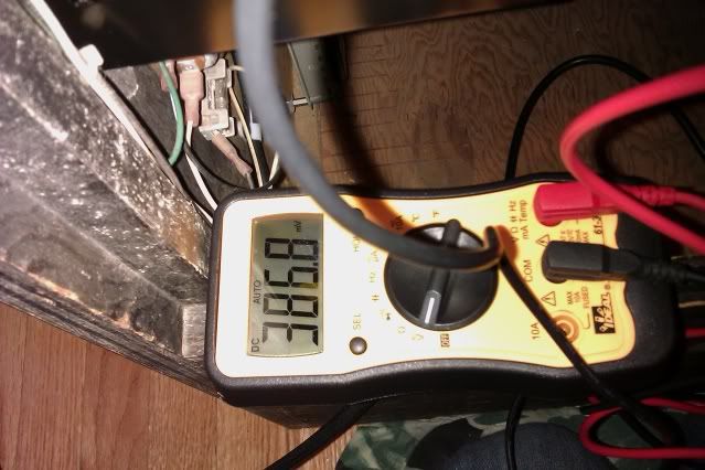

When I add in the Jammaboards 6-in-1 like this:
Jamma Harness --> 3' Jamma extension --> 6-in-1 PCB --> 3' Jamma extensions --> PCBs
I get a humming noise, games don't run, and it's like there's no power going out of the switcher.
+5 when hooked up to a single board:
+5 when hooked up to the 6-in-1:
Readings were taken at the switcher.
Any clue why it would be so drastically different? I got the same symptoms with two different switchers.

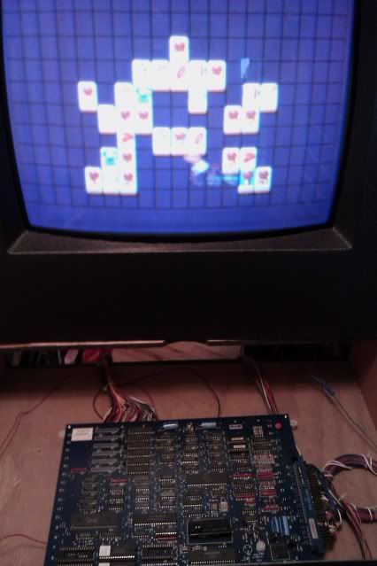

Finally got around to testing it tonight:
PCB hooked straight up, works fine:

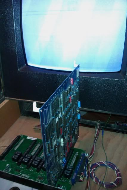

Harness > 6-in-1 > Game PCB (so no extensions), nothing, power supply shut down:

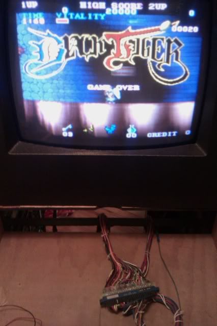

Harness > extension > extension > game PCB, works.
So it looks like it's definitely an issue with the 6-in-1 board.
