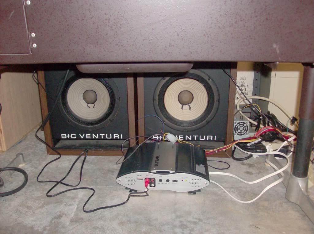

then hooked up my pc to the amp (3.99 for rca 2 mini jack adaptor) and hoked up the
old vintage speakers
fired up the old pc and
holy freaking crap i can play music for the whole naborhood from my workshop in the basment right from my pc

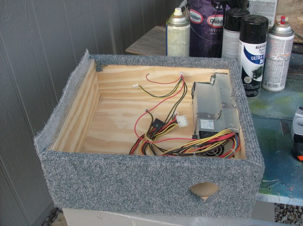

tommorow im going to build a small box (the size of the amp) and cover it in carpet
so i can install the pc power supply in and then screw the amp on top of the box so i dont just have the atx ps just sittting on my floor with a ton of wires laying around

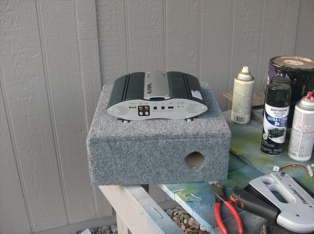

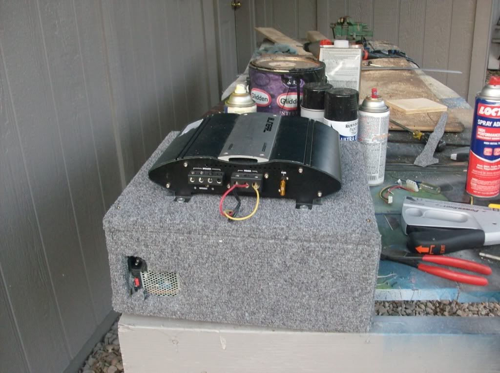

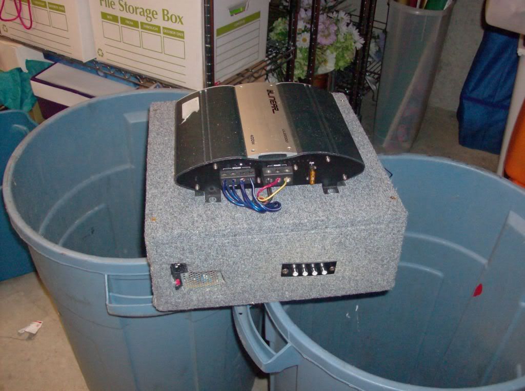

and now the amp no longer sitting on the floor with a atx ps sitting next to it

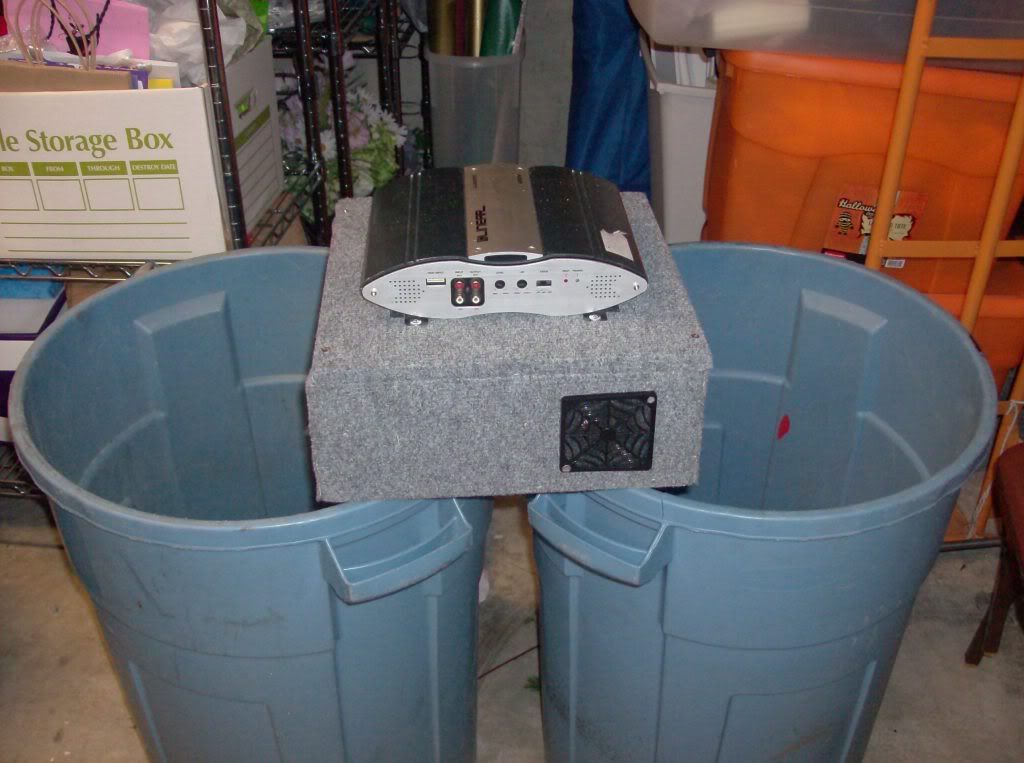

im going to run out tommorow and pick up a fan to install in the hole i cut in the front and ill get one of thoes fancy computer side fan covers as well to cover the hole then i need to bust out the dremml and cut a mesh peice to cover the hole in the back
i call it
PORTA POWER ! lol
added a 60 mm 26 cfm pc fan
and installed a fan cover on the front
also added a 4 port rca jack in the back(left out,right out,and 2 bridged out's for bass)
and now its totaly self contained and the atx ps has plenty of cooling power incase it getting a little over drivven by the amp
all thats left is to fond a medium i can use to make a grill to cover the back hole where the power plug goes
