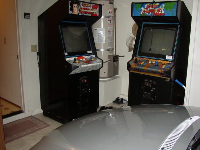

A buddy of mine wants to swap out PCBs in his Dynamo (upright) cabinet, but said the only part of the back of the cabinet that comes off is a small portion to get to the monitor. He's 6 hours away so I cant see the cab, and I don't own one to be able to tell him. I googled it, but nothing came up.
How the heck do you swap PCBs out of those things?
Cab looks like one of these:
To elaborate further: unlatch the cp through the coin door, fold the cp down, reach in and move the lock pins on each side of the cabinet (sometimes I have to hold mine up because they fall down a hair and keep the panel locked in), pull the panel out/up and rest it in the position shown above. Should be no wires or connectors to remove.
