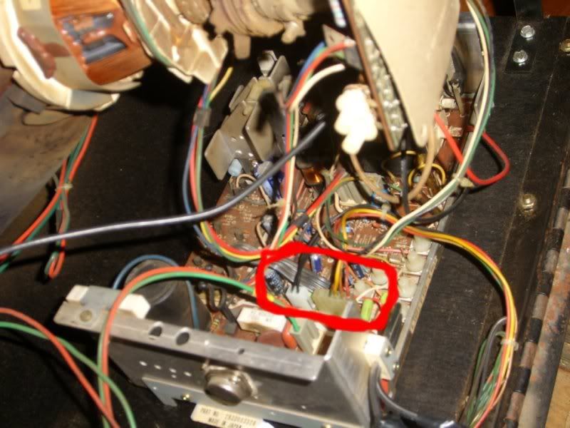

I've swapped monitors when it was the same brand, but not when connectors were different- so please help this ignorant soul. :)

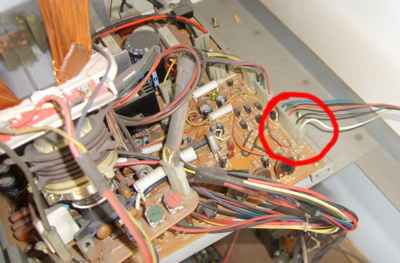

OK, so here's the monitor in the weird bootleg DK Jr ...one molex w/ 5 wires. I'm guessing RGB and power?
Here's my Pac cocktail monitor connection - there are 2 molex ...one has 4 wires (green, yellow, tan, and red) and one has 2 wires (both black)
I'd like to swap the DK Jr monitor (don't worry, it's not a sanyo) to the Pac cocktail...but it looks like the Pac cocktail has 1 extra wire. What should I do?

That manual took forever to download. OK, the Pac cab uses composite sync. I bet you will find continuity between the two black wires. They are your sync cable. The other cables are RGB and ground. Check the DK monitor for these inputs and coordinate accordingly.

OK, shows how much I know about monitors. I can put in cap kit but I don't know what sync is. OK - so ...if the Pac monitor has 2 sync wires and a ground ...does that mean the other monitor's black and whites could be sync and no ground? Or one sync and one ground? The only wires coming from the DK Jr. PCB to the monitor are on that one molex w/ the 5 wires as pictured.
I don't know if these labels help, but this is how each pin is labeled on the DK Jr monitor:
B (blue wire) G (green wire) R (red wire) VD (no wire) E (black wire) HD (white wire)

Your Pacman has a Wells-Gardner K4900 in it. From the right of the picture going left, it's Red/Green/Blue/Ground on the wide connector, then sync runs to the last 2 pins on the second connector.
