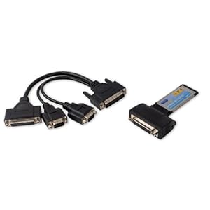

It's still not a "true" parallel port so the driver you would need to install will still emulate one. The major difference with internal PCI / PCI-E cards compared to the USB and PCMCIA you are actually adding a LTP port and the associated chip onto the BUS so it becomes a true LTP port.
The ExpressCard which is commonly found on newer notebooks is actually a combination of USB and PCIe and again similar to that of the USB where you are emulating a LTP port.
If the notebook has a true PCMCIA/Cardbus slot.. this particular card would have better chances at working than not, but again would not be a guarantee.

Looks like the new laptop has ExpressCard and not PCMCIA so I'll prob go with this guy:
http://www.amazon.com/gp/product/B0...&pf_rd_t=101&pf_rd_p=470938631&pf_rd_i=507846
2x serial parts and 1x parallel port:
It says its a PCI-e based true Parallel port (not usb emulated) so I'm hpoing it will work. I'll let you know how I make out...
Just a FYI, ExpressCard is designed around a combination of USB and PCI-e... There is some iteration of the USB spec at the heart of the devices. That's what I meant in my first post.
