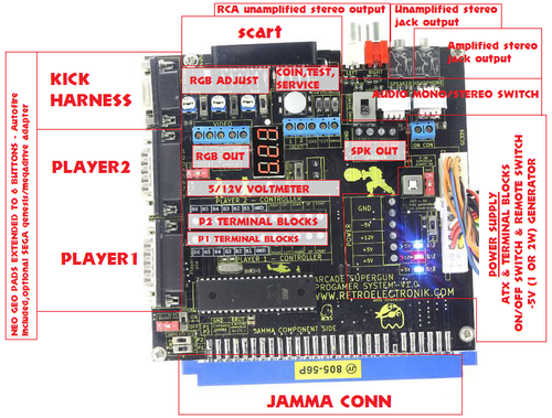

I have a Euro one (Supergun ProGamer RetroelectroniK Arcade Jamma - autofire,voltmeter included) off of Ebay for testing only on my workbench ->

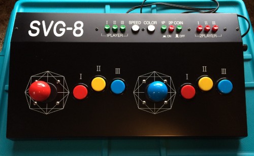

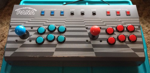

I have a few superguns. I haven't tried any other ones than the ones I currently own, but I know that I want a Sigma Raijin, a Sigma AV7000, and a Sega Boardmaster to add to my collection. Of the ones I own, all of them work great. The Japanese control boxes are awesome. They look cool. They are very sturdy and built like an arcade machine. They have real Japanese arcade parts installed so they play great as well. I have an SVG-8 which has 3 buttons per player and only outputs RGB. I take it to the Rocky Mountain Pinball Showdown in Denver every year for people to play and I have never had an issue with it before. It definitely gets the most use of all my superguns. I also have a Pana Custom Long. It has 6 buttons per player and outputs composite, s-video, and RGB video.

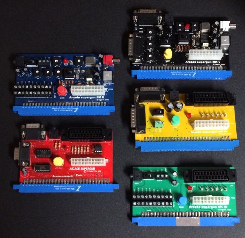

My barebones superguns work as good as the parts you use with them. I made adapters to use an arcade switching power supply with the 20 pin ATX PSU connector. PC power supplies don't let you adjust your +5v like a real arcade PSU. I use Brooks Super Converters PS3/PS4 to NEO GEO controller adapters to play the Vogatek Arcade Superguns for the MK IV and MKV. MKII and MKIII are direct wired for arcade sticks. The MKI uses 3 button Sega Genesis controllers. MK I, III, and IV use RGB Scart video. MK II and MKV have composite and s-Video outputs, but no RGB.
I would recommend any of the ones I own. They have all worked great for me. I have sold 3 or 4 of the Vogatek superguns over the years and I have not heard any complaints from the people who bought them.

SVG-8:
Pana Custom Long:
Vogatek Arcade Supergun MK 1-5:
