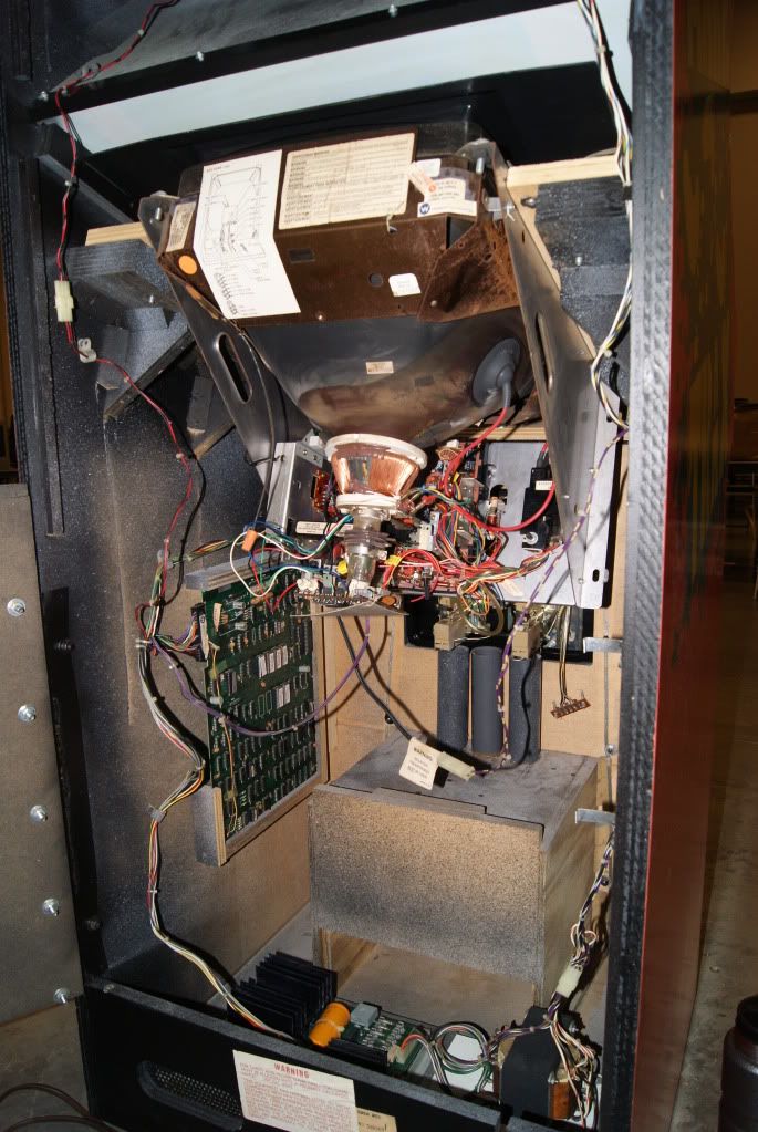

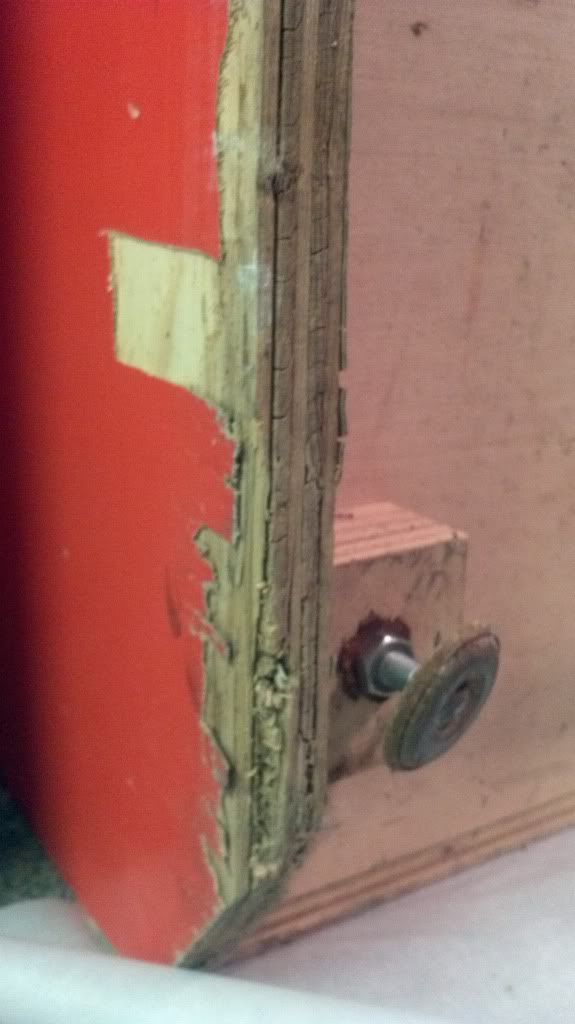

The cab itself was in pretty decent shape. A few gouges, some water damage near the bottom. The cpo had divots from where the joystick nuts were. Some people on here probably would have killed me for not just touching up everything, but i wanted this machine to be as close to perfect as i could get.
The machine was stripped and all the boards and wiring harness were cleaned. I sprayed the power supply mounting board and cleaned it all up. What a mess. The coin door was in pretty good shape, but the coin bucket door had a big hasp screwed to it. So i pulled that off and welded over the holes. Cleaned it all up and resprayed it. Resprayed the coin door and all the other metal trim pieces. I also scanned both sides, vectored the art and made the stencils.
I peeled back some of the water damaged areas and injected wood hardener with a hypodermic needle under the layers. I then clamped it with some parchment paper covered boards. That didn't work. So i injected a slightly thinned wood glue into the layers and clamped. That did work. It was time to move the machine out of the hallway (boy was my wife glad.)

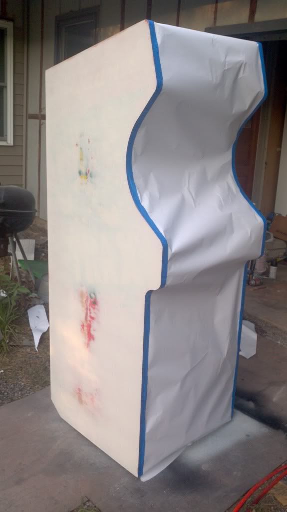

The machine was sanded and the gouges filled. The bottoms were fixed with body filler and then sanded. It was time for primer.
After the primer and more sanding the kick panel and monitor areas were shot with semi gloss black lacquer.

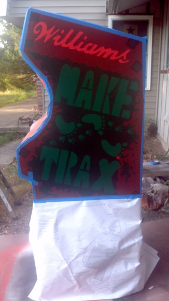

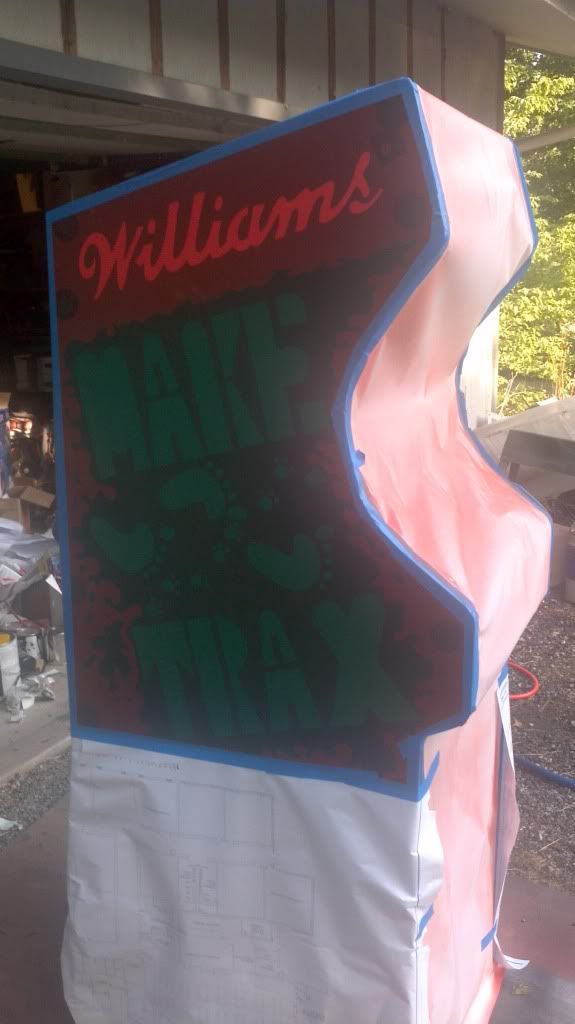

Here's a shot of the machine after the black was sprayed and masked, awaiting the red.

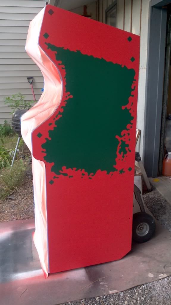

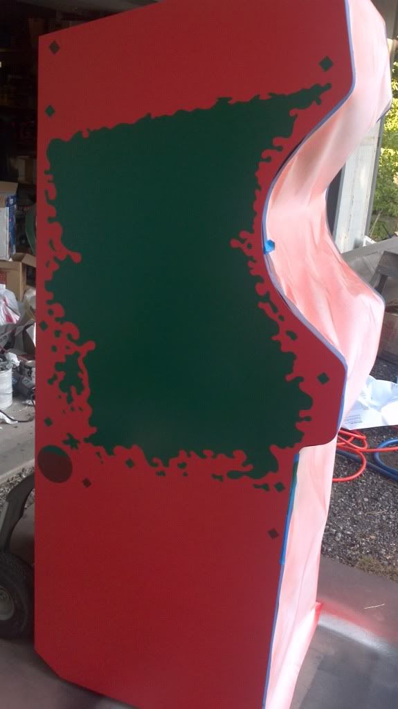

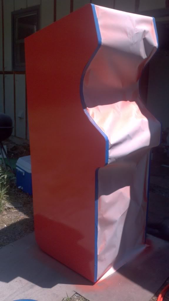

I then shot on the red paint, which was a "direct to metal" oil based paint.
Then i shot out to colorado for a week and let it cure real good.

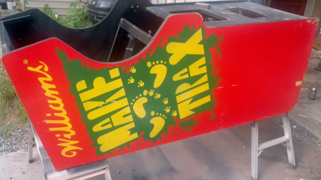

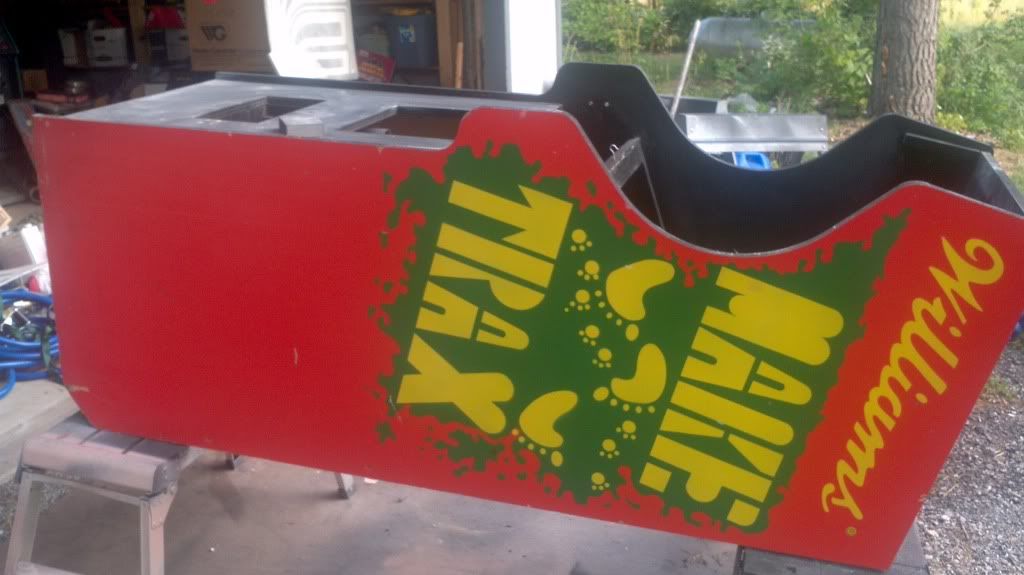

When i got back i sprayed the green areas with a semi gloss lacquer. The green diamonds are actually mask that was left behind for registration. The big circle on one side is an experiment i was trying to help size the artwork.
The finished green

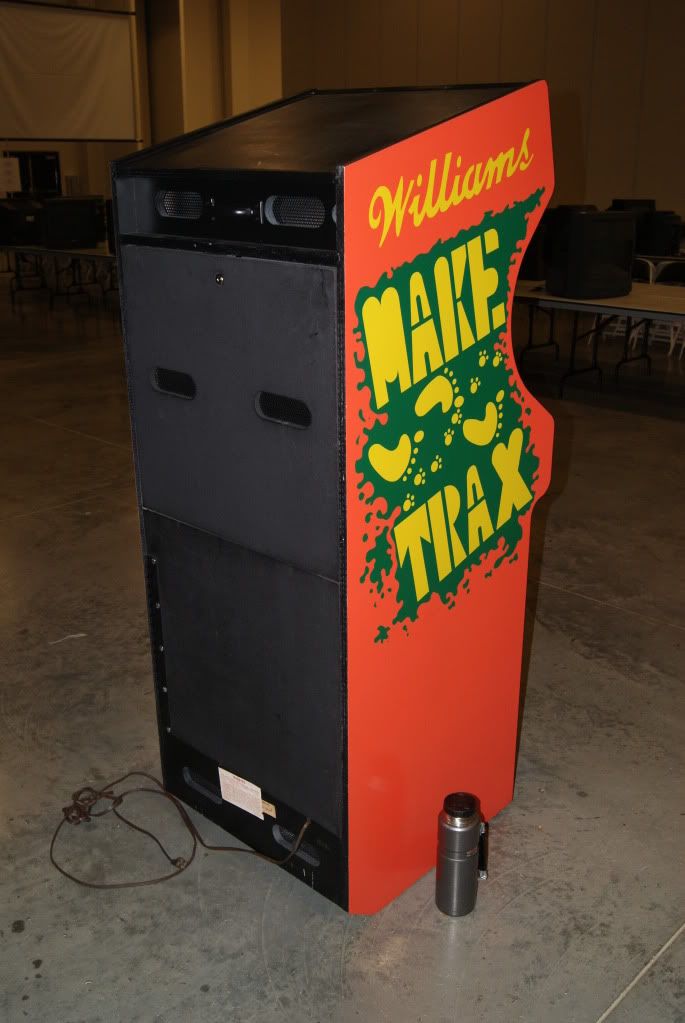

I used a semi gloss clear lacquer for the finish coats. I didn't intend to shoot a lot of the clear, but my first coat resulted in a sag. So i fixed that and shot again. And of course sagged in a different area. Fixed that and followed it up with a couple more. I was worried the clear might make it stand out and look too fake, but it didn't. I'm really glad i put the extra coats of clear as it relay made the art work pop.

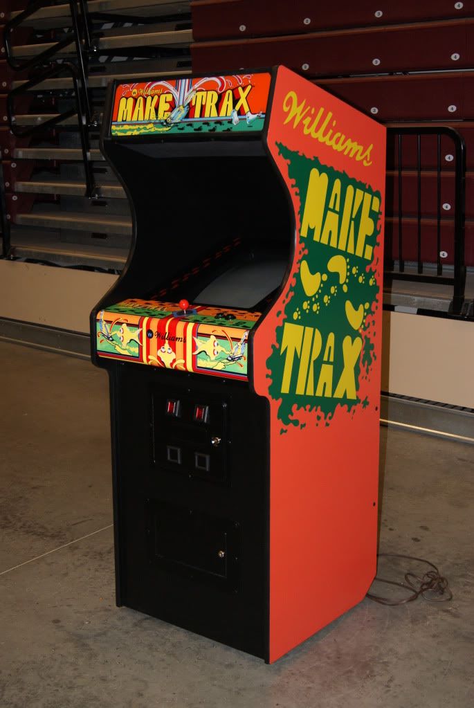

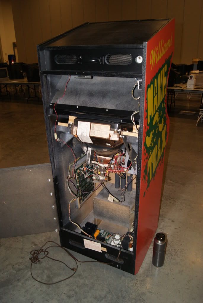

I then filled the divots where the joystick mount nuts were and put on the cpo. I wished i had sprayed a coat of primer on the plywood control panel as you could see the plywood layers and the body filler through the cpo a bit. Oh well. Then i put everything back together and started to freak out when the monitor wouldn't work right. Got that fixed with the help of KLOV. Then it was finished! The main thing i learned was i am using lacquer for these from now on.
I wrapped the machine, loaded it on a trailer (with four other games), and headed for the Grassroots Gaming Expo in Outtumwa Iowa. Of course we have a 6 week drought, but the second i take games on an open trailer that fixes that. Forget rain dances. Load up some games on a trailer. Fortunately, i had it wrapped well and none of the games took any damage on the way there (not so lucky on the way home.)
