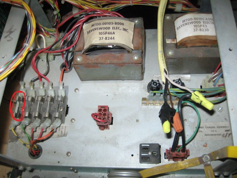

Hi,
I have a Super Pac man cocktail table that keeps blowing a fuse on the power supply,
I replaced it w/ the same fuse (BUSS MDL 5 / 32 Volt) and it blows as soon as the game is turned on.
Does anyone have any ideas or suggestion on where to begin to troubleshoot this issue?
(I have not yet worked on power supplies)
Thank you!
What is the fuse protecting? which one is it?
can you post a pic also plez. I suspect a wiring problem, a connection touching metal (ground), bad fuse holder, or a bad cap. and in that order. With power off and cord disconnected from any power source, meter from each side of fuse to ground and see what the ohms reading is; 2k or 20k scale should do it. I would say it is very low if not a dead short to ground.

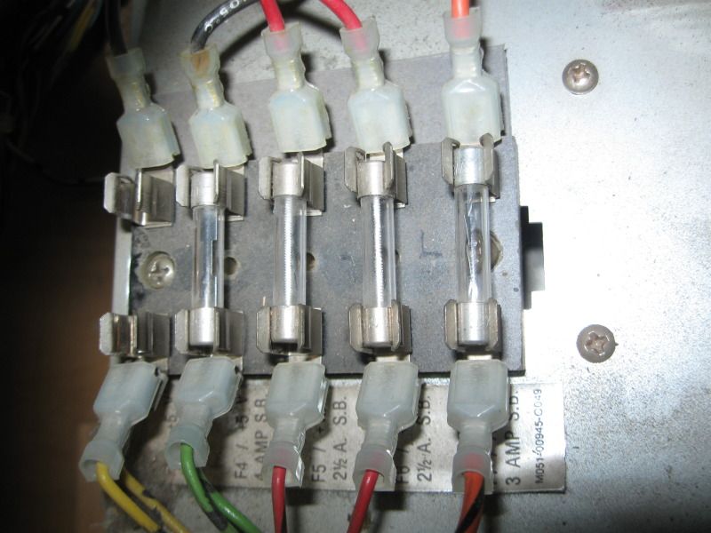

Heres a pic of the fuse that keeps blowing (its the empty slot)
Thanks!
I would say remove the two screws and look for anything under the fuse block that might be shorting it out right there.
That fuse looks like it is coming from the transformer right near the fuse block and coming in from top and going out the bottom. If it is the fuse holder, when you unplug the bottom connector and put in a new fuse, it will blow again. If it doesn't then there is a problem somewhere with that yellow wire or the associated pcb, rectifier, etc. That is ac voltage also so set the volt meter accordingly when measuring the voltages.

Power supply
Are there any obvious hacks? I see they used 12g Romex to feed the machine.

PUTTS5205: I dont see anything that looks like it has been hacked, but I'm not really sure what to look for either. What is 12g Romex, does that refer to a type of 12 gauge wire?
