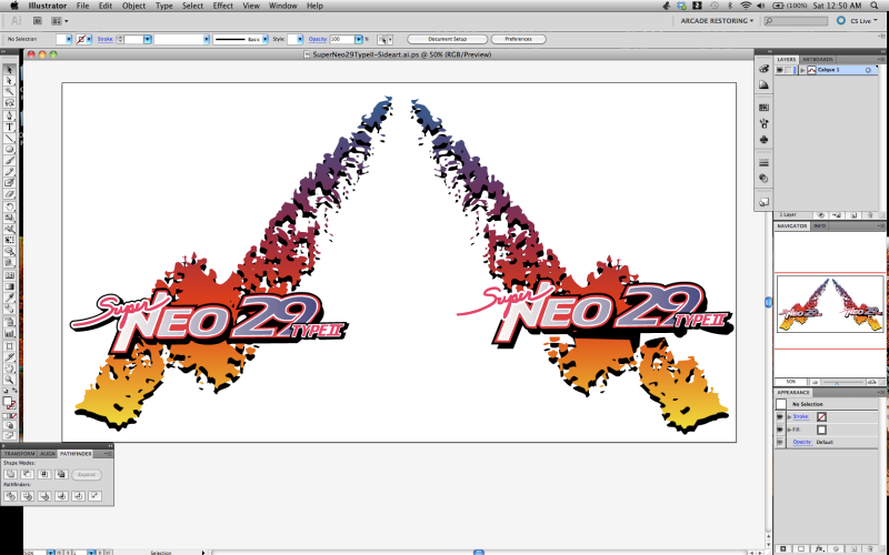

So now that you thread jumped me, does that mean you're going to do me some custom artwork? :D
