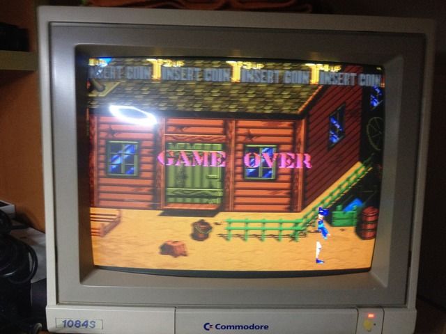

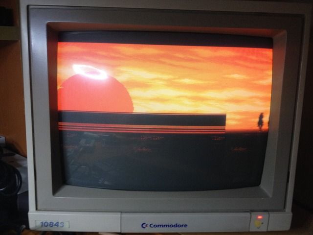

hey guys,
Asking your opinion about this glitch...
Sprites are shifted quarter screen right and dissapear on the left 3/4 of the screen area. When they are beyond the visible right screen then some bars appear (as seen on the pic).
Some more pics...
And the mask rom test...

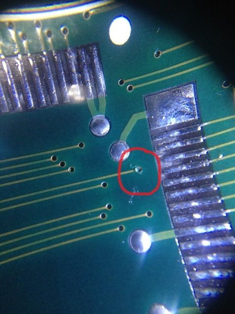

However, when replacing 053245, I noticed one rusted via underneath the IC.
Followed and tested it which turned out to be disconnected due to corrosion. Apparently this via was on the line which connects pin 25 of 053245 to pin 18 of 053244. I know, these two guys works together and guessing this connection is part of the communication bus between them...
Anyway, that fixed the problem...
