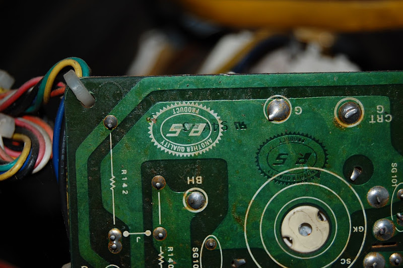

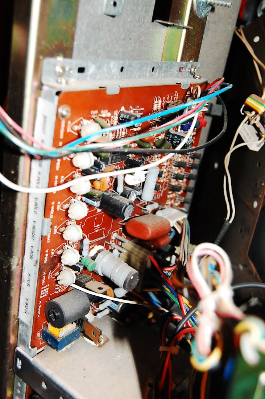

Trying to figure out what the monitor is, only identifying feature (besides the serial #, no product #) is a logo that says PS and says "Another quality product" surrounding the PS logo. Any ideas?
take a pic of it, the crack team of monitor specialists can probably tell you right away. lol
Hows that?
hard to tell, I'm not familiar with that one. looks much like this though:
maybe someone can prove me wrong. :)
EDIT: your best bet is to start a thread in the Monitor Repair forum... maybe that's one no one's catching it here.
Man you're good. It has to be that one, it has the same switches at the top left, same shielded flyback area, same type of v-sync and such adjustment knobs. Perfect.
I was getting worried, I was starting to run out of oddball monitors on Bob Roberts monitor ID page, and that was the last one. lol
I don't know any model differences or anything. I tried going to Kortek's site, but they have NOTHING about arcade monitors on it, so I don't know anything about the model differences or whatever for these.
you said it was playing blind, did you make sure that the monitor's getting juice? I got a Blitz '99 at auction where the monitor wouldn't come on and it turned out to just be unplugged (and highly fucked out of adjustment LOL). sometimes it'll be plugged in but there's no power, so if it's a cab that looks like it's been 'molested' there could be something else that came disconnected elsewhere. best way to verify is that you're getting voltage at the monitor's power connector testing with a DMM.
maybe you'll get lucky and it's something simple like that. I love stupid, simple solutions.
if you look at the back side of the monitor chassis, you will most likely find some printing along the edge that says "K1-2-V0". Several Kortek chassis models had this board. I just fixed one labeled as a KT-2001SF. You will typically find the label on the right side of the cage around the flyback if it hasn't fallen off.

Check for a cold solder joint on L402, and do a cap kit and see what happens...
