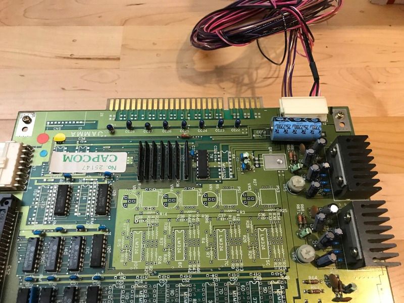

I just picked up a Street Fighter 1. I know button 1-5 is on the jamma. Button 6 is on a 3 pin cn5. Now on my board I have an unpopulated 10pin cn5 is this the same?
Also just figure out it's stereo sound
Interesting indeed! Yours is a board I haven't seen before...it's the early pneumatic pcb yet its missing the sensors. But I suppose you could find those parts if you desire. Anyway, later versions of the pcb do not have the space for the pneumatic button sensors.
I'm just looking to hook it up to jamma and use the button on my Blast City. Thing is im missing a punch and a kick unless it's a 4 button game?
I guess when I get home I can start bridging things
i would put it in switch test and ground each pin of the kick harness connector to see what is what
edit: might want to meter the voltages on all of the pins first just to be safe. i'm not sure how those pneumatic control panels worked.
What is the kick harness connector? From my quick search it's cn5 is a 3 pin and I have an unpopulated cn5 with a possible 10 pin. My board does not have the pneumatic sensor and it wasn't remove as it look factor stil

I just bought a stand alone pcb. Button 1+2 is punch and 3+4 is kick. Button 5 does nothing and 6 still need to be located. The other problem I'm having is the pcb does not sync with my psone LCD testbench. I have to wait until Wednesday until I get access to the clubhouse again. Sigh 1st world problem 😅

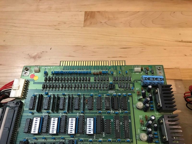

Do not use the 3 pin. Thats not your Board.

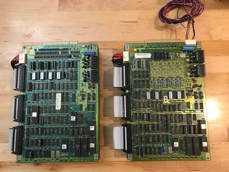

Here are the 2 Versions I have for Display. the one on the Right is yours:
Board A the Right one (Same as yours)
Board B the Left one w/ the other kick harness map:
CN6 is what you want. Located top Right of the PCB:
1 Kick 3 P1
2 Kick 3 P2
3 Punch 3 P1
4 Punch 3P2
If you want epic Stereo sound also on CN6:
9 Speaker 2-
10 Speaker 2+
11 Speaker 1-
12 Speaker 1+
That's how I am running on my Deluxe Cab.

@ Biomech011 wow 7 boards. You sir are the best. Here I thought cn6 was strictly sound. It did cross my mind why there was 10 pin for sound. I will have to test Wednesday when I get access to the room. I will have to make my own harness as I liken to get this going for a tournament of power type of thing. Player playing SF1,2,3 to find who is the best 😄. Can you drop anymore knowledge bomb on between the 4 different revision?
Sure.
PCB #1 is the Pneumatic Board.
PCB #2 Is the Pneumatic Board w/o the
Pneumatic features like yours.
PCB # 3 is the other board shown Also a 3 stack PCB like 1 & 2.
PCB # 4 is a 2 stack Board.
Hit me up anytime w/ Question.
