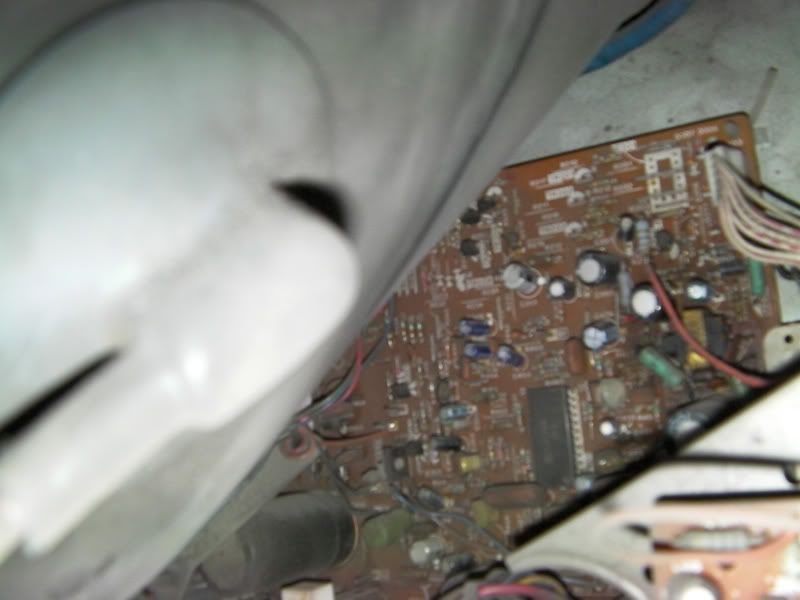

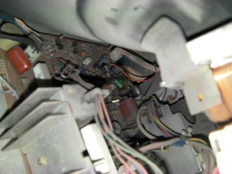

Here are some photos... the chassis is, of course, in their tight so these were taken "blind". The first one shows a pretty large CAP... I don't recall having one that big on a normal 20EZ?
Can you see what it is plugged into power wise? Or measure the power as well? Lots of Transformers stepdown to 100VAC.
That black cap looks like the standard cap that I've seen on all the ones I have. Some of the others have been replaced, but I don't know about all of them. I'd do a FULL cap kit. Most kits don't do all the caps from what I've seen.

And yeah, I took a better look at your photos....it looks like a Nintendo EZV to me.....The inversion section is empty, choke L601 is the EZV type, and I noticed the external inverter board mounted to the flyback cage (the EZY did not use an external inverter board).
