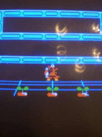

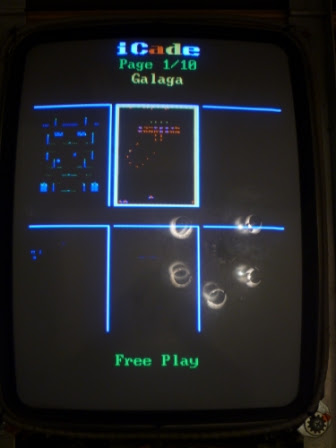

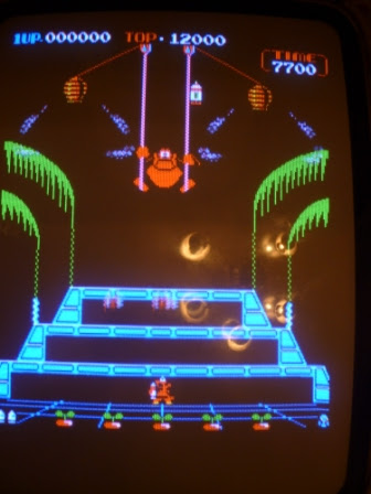

So when I put the color test screen on, it looks ok. I'm not sure what's going on with this, but for some reason the blue back ground in the Icade select screen doesn't show up, and there is some distortion (This board works fine on another machine and I tried two different boards in this one, same thing) the monitor is in a Space Invaders machine, Part 2 color. It is recapped (for those of you that have been following at all, the other one was recapped and works GREAT, this one, no change in the image.) The screen that is the weirdest to me is the DK 3 where the brown on DK is almost black. It's almost like background colors do not exist.
What monitor chassis is this?
Did the other chassis work great with THIS tube?
