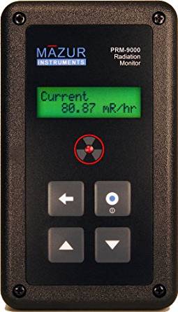

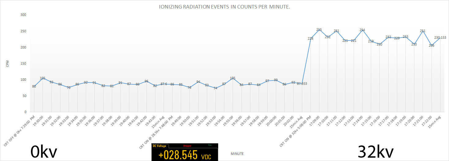

Purpose: To observe and determine radiation event differences on a CRT when the flyback anode high voltage potential exceeds normal operating conditions.
Since literally almost all monitor boards that I see in the amusements industry have its flyback high voltage potential generation factored by the monitor deflection coil (yoke) this is to address the concern of mismatching monitor boards to deflection coils it was not designed around.
Potential causes for excessive high voltage:
Monitor yoke mismatching. Flyback pulsing capacitors. Excessive monitor chassis B+. Incorrect glass tube used.
Charted is ionizing radiation events emitted from a 20" CRT acquired with a MAZUR PRM-9000 Radiation Monitor. The radiation counter has been positioned 1" from the face of the tube in the same spot through all 3 test modifiers.
The first 15 minute segment average CPM at the CRT turned off with 0kv anode voltage potential resulted in and average count of 87.6
This off state would include background radiation and tube elemental natural decay. I suspect there are possible radioactive phosphor isotopes contributing the higher than normal background readings of 29 CPM
The average background radiation activity level reading with the instrument set on an inert wooden counter was 29 CPM
The second 15 minute segment average CPM at the CRT turned on with a sustained 28.5kv anode voltage potential resulted in an average count of 87.933.
There is no detectable CPM difference detected between the CRT being off and turned on with a normal operation of tolerance of 28.5kv. However, I would expect a verified small increase if the same test was done over a long period such as 24 hours. Other instrumentation and methods would be able to demonstrate the subtle change better.
The third 15 minute segment average CPM at the CRT turned on with a sustained 32kv anode voltage potential resulted in an average count of 230.133
Conclusion: A 3.5kv difference anode voltage potential above a normal operating potential of 28.5kv resulted in a 161.7% increase in ionizing radiation event counts over a 15 minute period on the PRM-9000.

Stupid question, Chad, but wouldn't you be able to measure the incorrectly high flyback anode voltage with an HV probe and see that it was wrong?
That is exactly what I did as you can see in the chart.
segment 1 0kv
segment 2 28.5kv
segment 3 32kv
all in a controlled environment. it was wrong because i introduced the excessive high voltage in order to conduct the research as written on first post.
segment 1 0kv
segment 2 28.5kv
segment 3 32kv
So I guess my point is that if you swap yokes you should be able to tell if you're in a position where you're dosing yourself with radiation because the HV probe will show too high a voltage.
If you swap yokes and the HV probe doesn't show excessive voltage then you shouldn't have to worry about excessive radiation? And you should still be somewhat concerned about defeating the X-ray protection circuit by introducing a new yoke.

The x-ray protection circuits typically work by monitoring the chassis B+, and are designed with knowledge of the ratio of B+ into the HV circuitry to anode voltage out. Just as a completely arbitrary example, if your B+ is 180 and nominal anode is 18kV, you have a 100:1 ratio. So if your unsafe anode voltage is 22kV, you set the overvoltage to trigger at B+ of 220V.
If you modify the chassis in such a way that the B+ remains the same, but the ratio of B+ to anode voltage changes, the overvoltage protection obviously can't work as designed.
Yep... that's exactly my point. I don't see how changing the yoke can change the ratio of B+ to HV, which AFAIK is solely dependent on the ratio of transformer turns inside the flyback. If he can show that an incorrect yoke does significantly affect this, then it'd be interesting. By saying that 32kV in a tube increases X-Ray emissions over 25kV, I'd say "Duh" (the sticker on the back of the tube says that).
I personally think Chad is reaching with this one. He's making no meaningful connection between the yoke and HV/X-Rays in this post. IMO, if anything is going to create unsafe HV, and therefore increased X-Ray radiation, it'll be improperly manufactured flybacks, not a poorly matched yoke.
I do agree that by "ohming" a yoke, you don't get all the parameters, and aren't guaranteed a compatible part... but I disagree that it'll cause a hidden dangerous situation that can't be easily checked. AFAIK, the construction of a TV/arcade monitor yoke is generally similar, so if the wire gauge used on the yoke is the same and the DC resistance is the same, then the inductance/reactance will be similar.
More interesting "research" would be to measure the resistance and inductance of a bunch of yokes and see how much they track each other. If it could be shown that resistance and inductance aren't related, then you could make a case that "ohming" yokes doesn't work.
