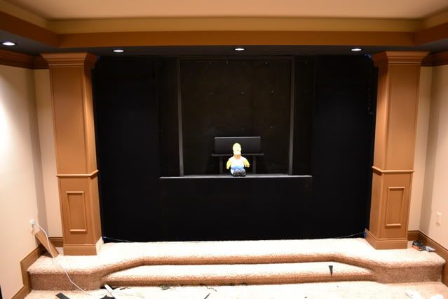

I went with an acoustically transparent screen which allows all of my speakers and sub-woofers to be place behind the screen out of view. I need to take some new photos but Homer gives you an idea of where the center channel sits. This "anchors" the dialogue to the center of the screen.
Plus, I added Aura bass shakers and line-filter so the seats shake whenever there is deep bass. The kids love the shakers for video games...gives an extra kick to explosions. These were all taken during the construction process, I need to snap some pictures to capture the finished product. Feel free to send me a PM if you have any questions along the way, I learned a lot by trial and error.

Sound treatment is important. I have a special insulation on the wall behind the screen. You can see it behind Homer. It stops the echo from the sound bouncing off the rear wall, front wall and back again. Without something like this your dialogue will sound washed out. Most people build wood frames and wrap them in fabric called GOM. Behind the fabric is the special insulation to absorb the sound. This is what you described as fabric on the walls.
Color is important, especially on the screen wall because the screen reflects light back to the audience causing a glare. Notice all the black around my screen...that is a velvet type material that gives the screen the theater feeling its floating and absorbs the glare. In theory, you should use flat paint in the room and the entire ceiling should be painted black.
My wife was concerned a all black ceiling would look bad...like a cave. My solution was to paint the underside of the trey ceiling black. Again, use flat paint and dark colors to cut down on reflections. The camera flash makes the room appear lighter than it is in person.
