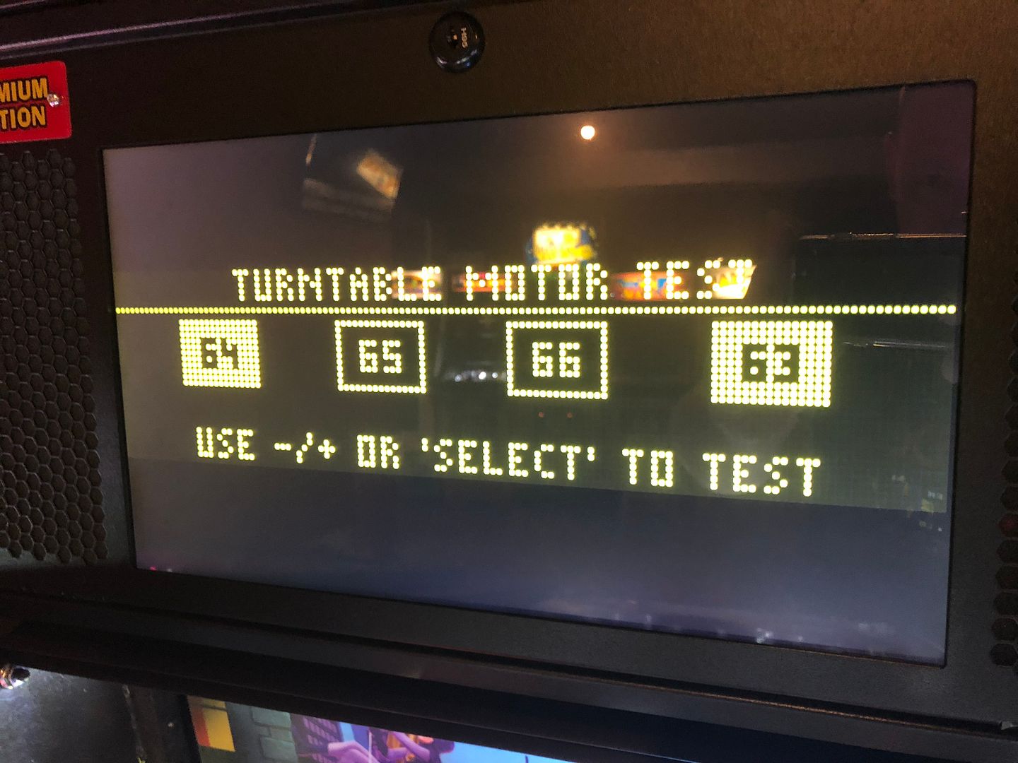

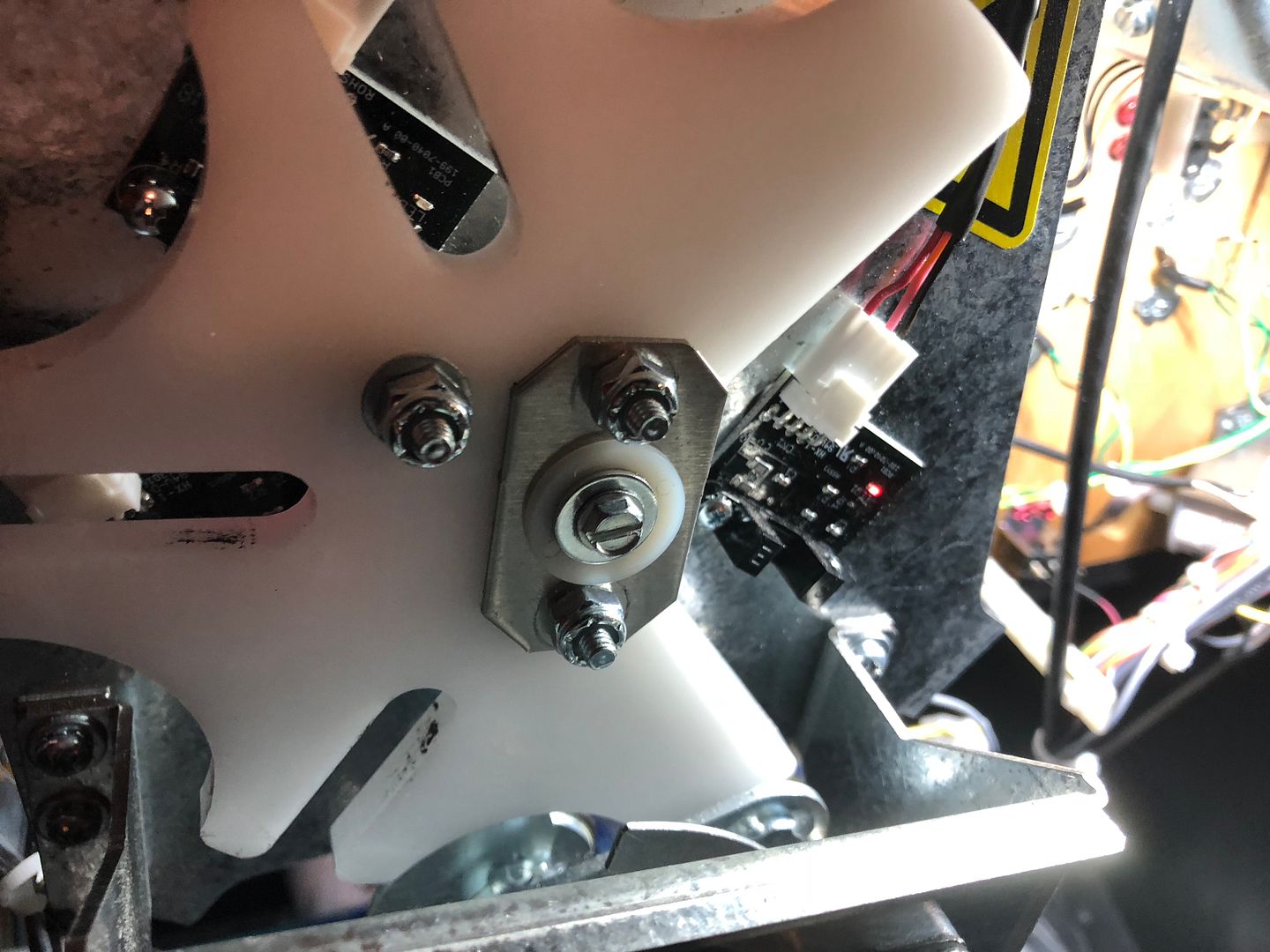

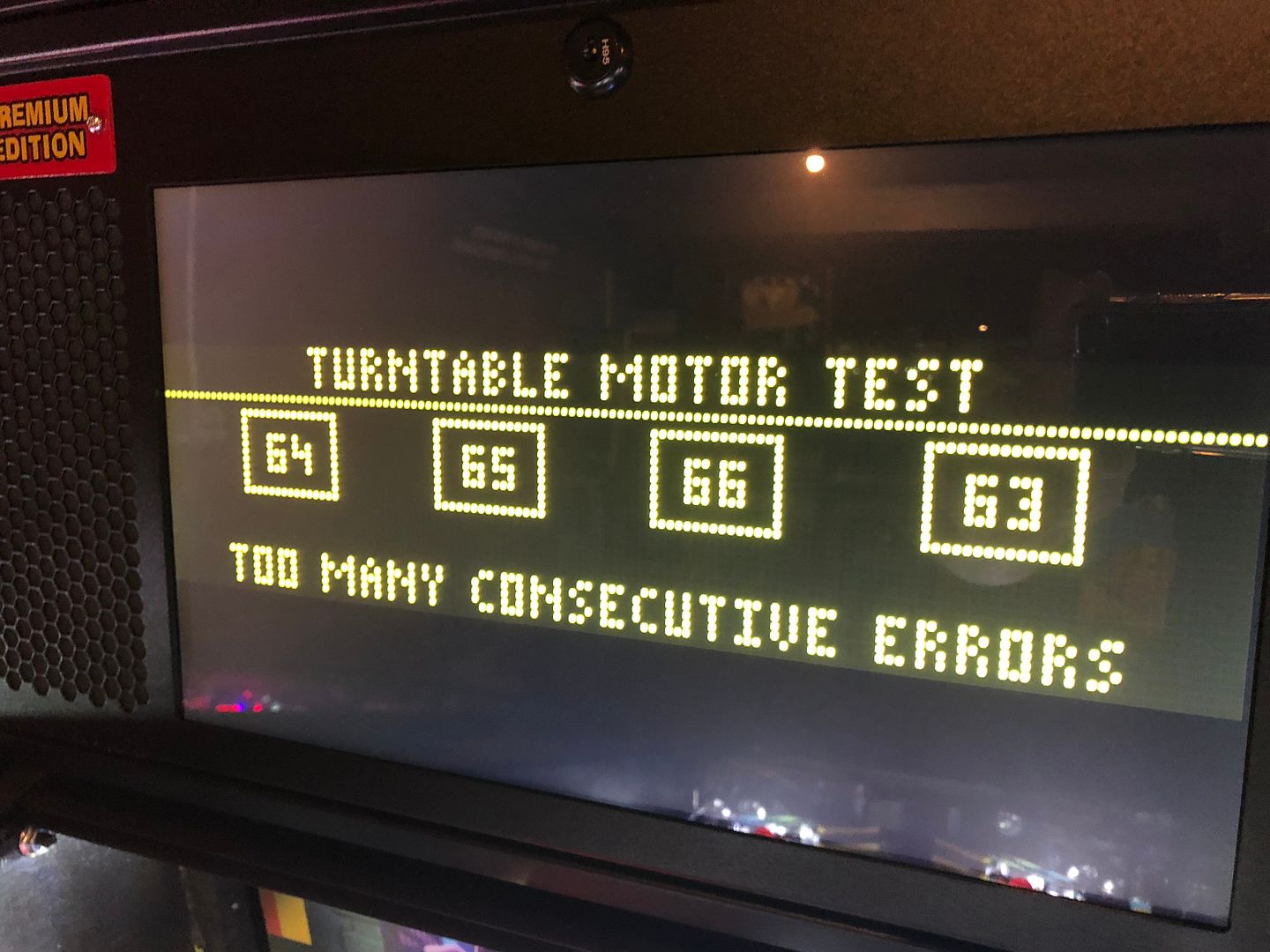

-) Batman '66 Premium - The screw that keeps the bottom of the turntable secure was loose, causing it to sit too low. This resulted in the optos not being able to sense what position the table was in and it eventually stopped rotating. Had a message that says "Too many errors." Also had two screws come loose from the pads at the ends of the ramps and were sitting under the playfiled.

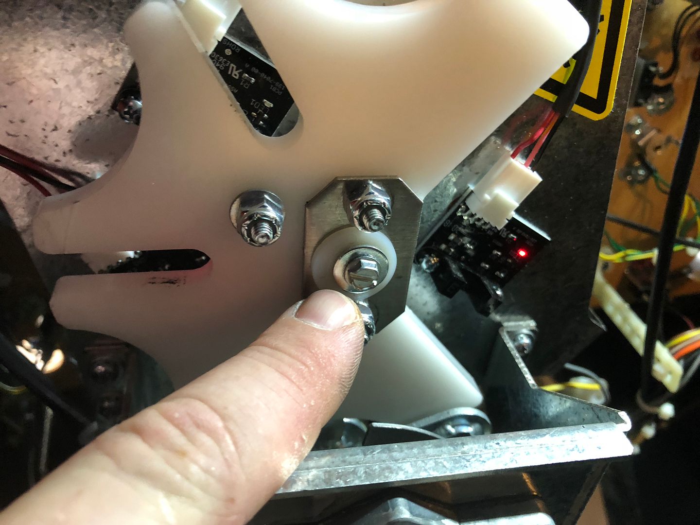

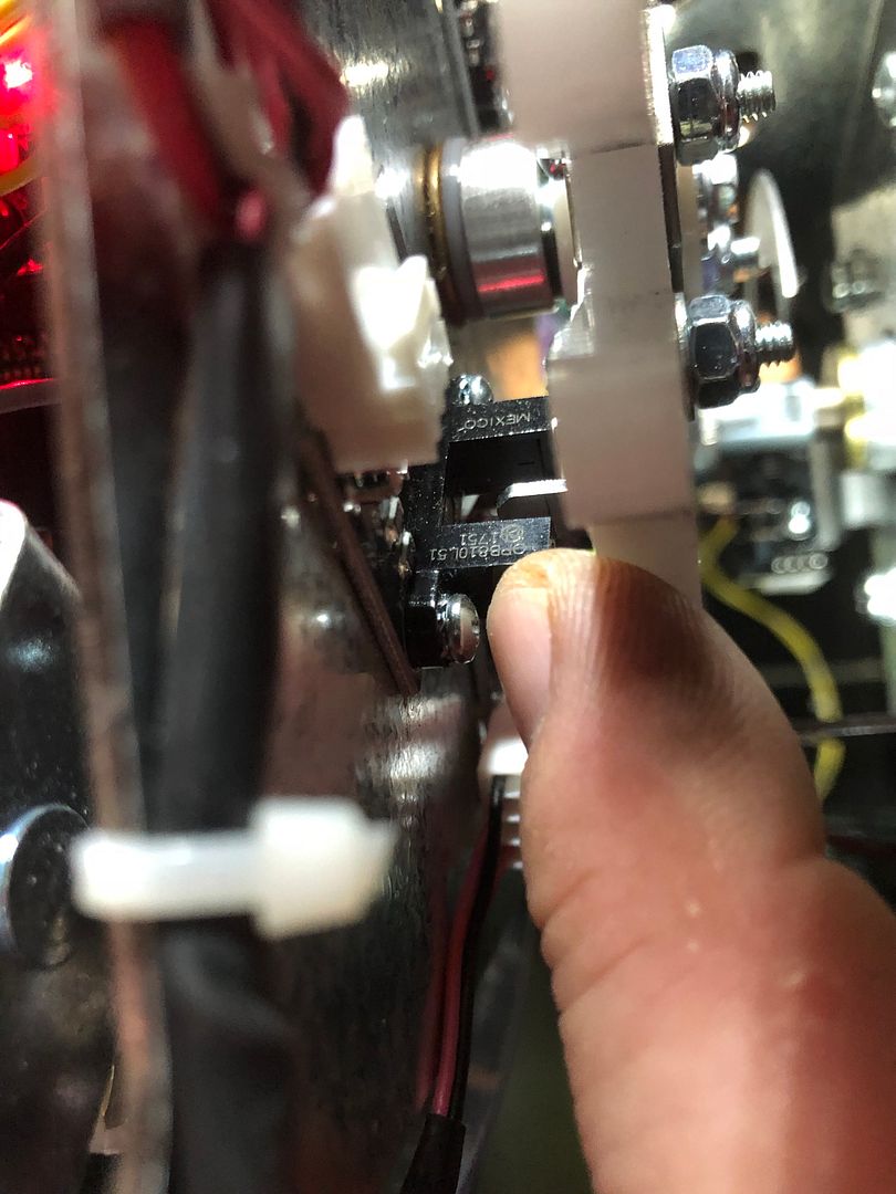

Yes. All myself. They weren't hard to figure out. Just disappointed. I'd have to say 'Tallica, but I'm a little biased. Here are some pics of the Batman issue. The screw that holds up the turntable was loose and was allowing the table to sit too low for the opto's to register...

That escalated quickly! I would advise against red Loctite, as it sometimes needs heat to be removed. Lots of plastic parts around that screw...
I usually use blue, and if blue can't hold I resort to red.
I knew your comment would be about the red loctite before I finished scrolling down, lol. Kroil works well without heat.
