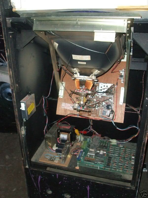

Can anyone take a couple photos of interior cabinet. Need to position board and switcher correctly. Not much room to work with right now. Also to help with correct wiring positions.

Received board today but my monitor crackles when I turn it on and my monitor horizontal hold is not stopping the screen from going left to right and v hold isn't much better. I just cannot stop screen from chasing. Any tips?
Both holds seem pretty random on what they want to do. V hold will slowly go up then change and go down without me touching it.
ImageUploadedByTapatalk1334646289.152681.jpgDue to the snag in this v/h hold issue I painted. The v/h hold is so sensitive on this thing and it does what it wants. I hope I'm close to getting this done with this.
Sounds like one or more of your syncs are not hooked up right. I had the exact same problem with a game. Once I corrected the syncs, everything locked in EASY!
Thanks, I will check that out. So your holds we're too sensitive and it randomly did what it wanted?
