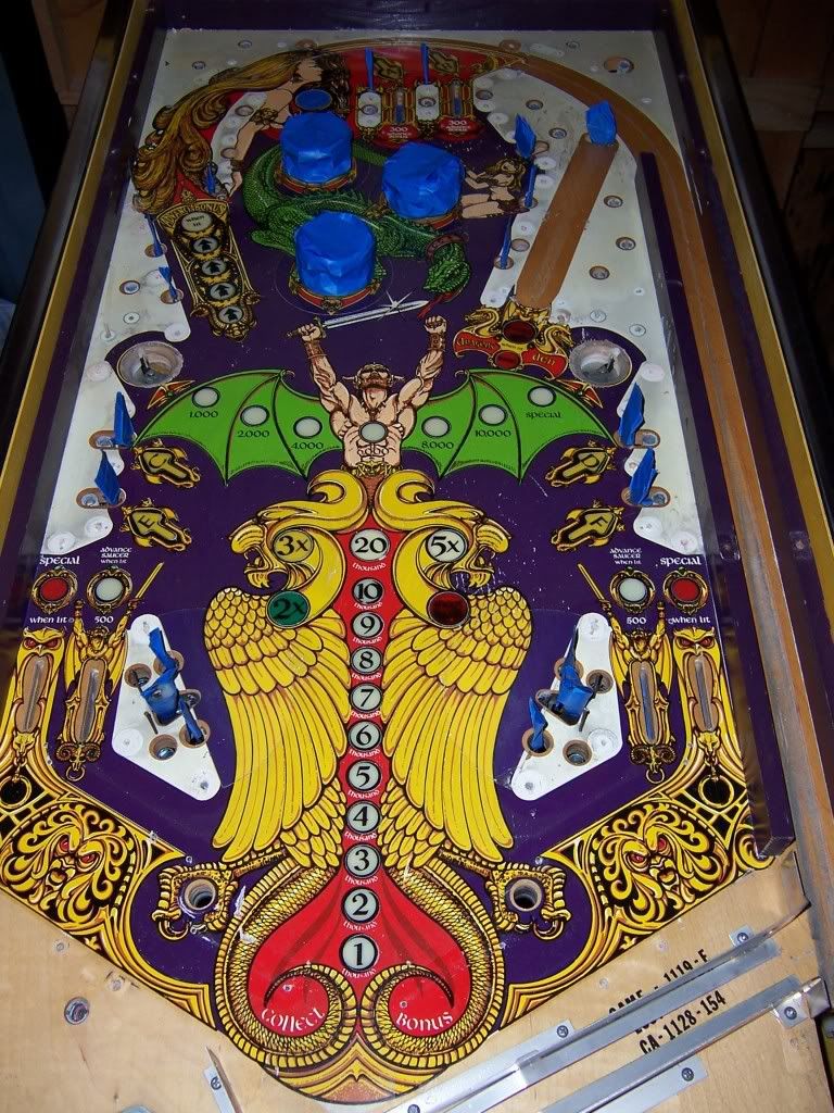

Playfield is in great shape, started up and played, everything seemed functional.

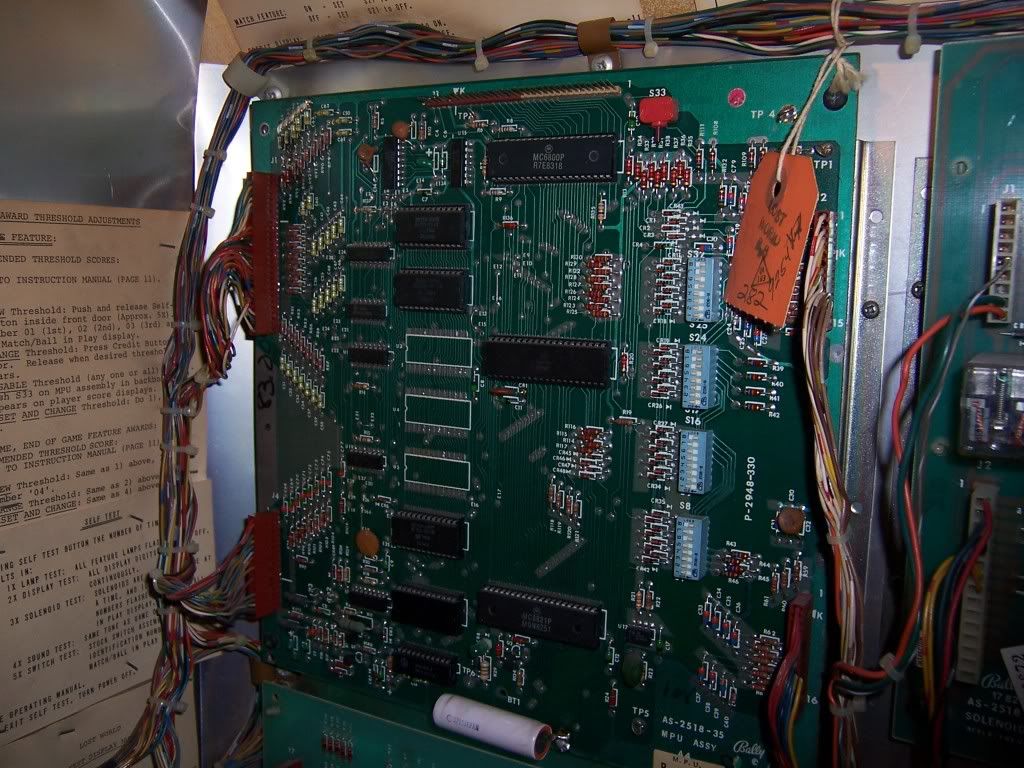

I want to perfect the playfield, seal it up, and put some new electronic parts on it so it is dead reliable. Some pics:
Here are my questions:
What is the best store bought sealer for the playfield?
Spray or brush-on?
Oil or Water Based?

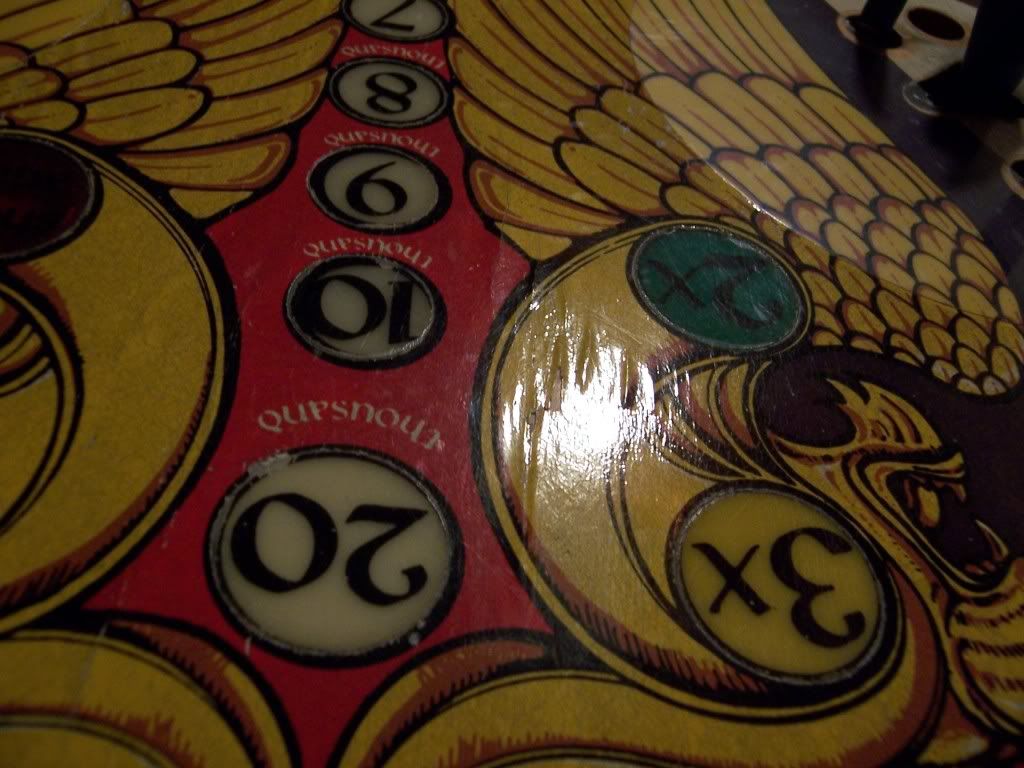

Another Q: This was in a humid basement and bits of the playfield started to bubble. Whats the best way to re-glue the material back down so its flat again? See pic:

Start by cutting the battery off the MPU. Then read this:
http://pinrepair.com/bally/
If you have questions that are not answered in the site above then ask them here.
Hard to say about the ridges in the playfield. I would see what they look like after cleaning. Might have to remove them and touch up those areas or they might stick down when the clear is applied. They might also be due to the wood swelling in which case they're going to be tough to fix. You'll probably have to block sand them down and touch-up. You won't know until you've done a good cleaning. I would use magic eraser but I don't see a lot of ball swirl or crazing (beyond the ridges) so don't go crazy with it and whatever paint comes off will have to be touched up. There's no point in trying to save loose paint.

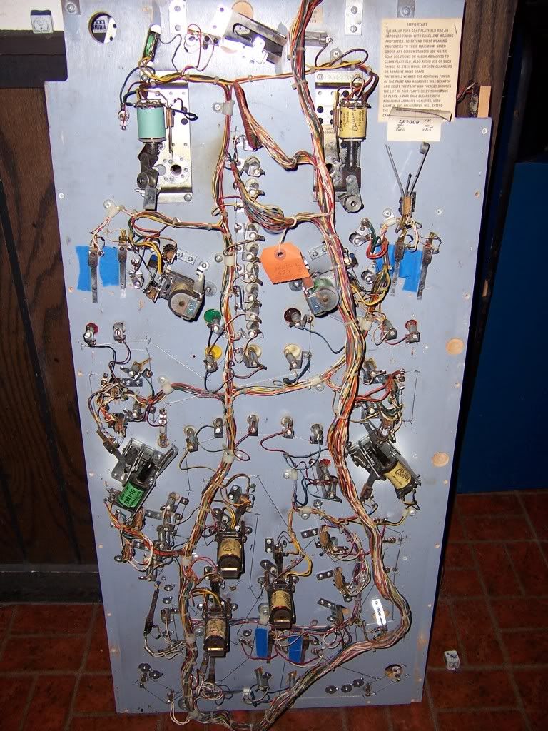

I would use Varathane for the clear coat on that machine but opinions will vary. You'll want to remove the pop bumpers and drop the switches down under the playfield. You'll need the top of the playfield completely stripped if you're going to clear coat.

First if you're going to do it right, get all of the mechs off the top of the playfield. Remove the Pop bumpers, drop all of the switches below the playfield and tape it off. That way when you go to spray the clear you'll get a nice even spray across the playfield instead of the mist hitting the pops etc...

There's a LOT more to a clear coat job than just shooting the paint. It's going to be virtually impossible to block sand the playfield with the switches installed. That's one reason among many to remove them. You don't have to remove them from the game. Just remove the screws and drop the switches under the playfield as I originally suggested.
Not to mention every step being easier like cleaning, polishing, etc... I used to try to shortcut the pop bumpers all the time and always ended up removing them later.
You could probably leave all the stuff on and still achieve a good result. It's just going to be a lot more difficult than doing it the right way in the first place :)

Ok Lindsey, the ENTIRE playfield is now stripped.....wasnt bad at all.

I have varathane and duplicolor clearcoat. Torn between the two. After testing both on identical surfaces, the auto clear is the winner... goes on smoother, dries thicker, much shinier. Im gonna give it a go tomorrow, the playfieldy
is all touched up and looks awesome.
*Update*
I ended up going with the SprayMax 2 part Clear in a rattle can.......
Excellent decision!
I have 2 coats on it right now and its a smooth sheet of glass.
I didnt quite get the purple matched perfectly, but I dont care. Im doing this under Fluorescent lights so once the pin gets re-assembled and back in my basement (in near darkness) all sins will disappear.
