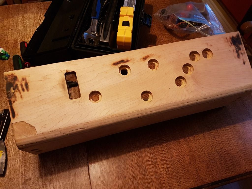

Since I'm locked out of the garage for a while (it was -25C / -13F this AM) I've brought my Stargate Control panel in, and started working on it.

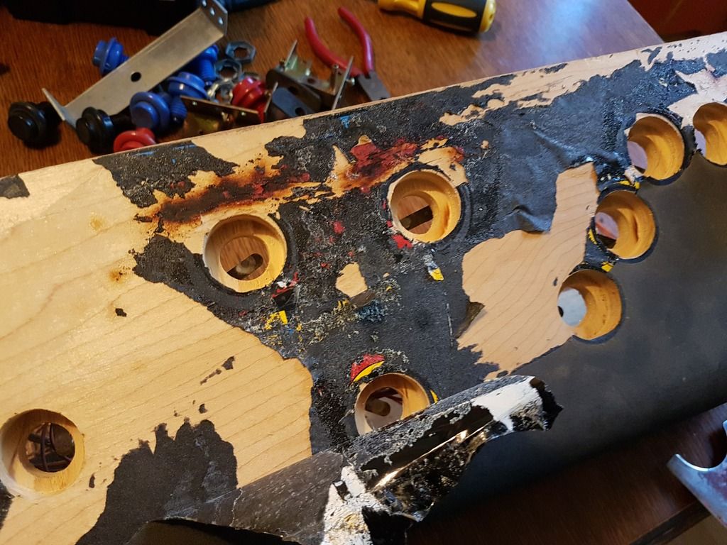

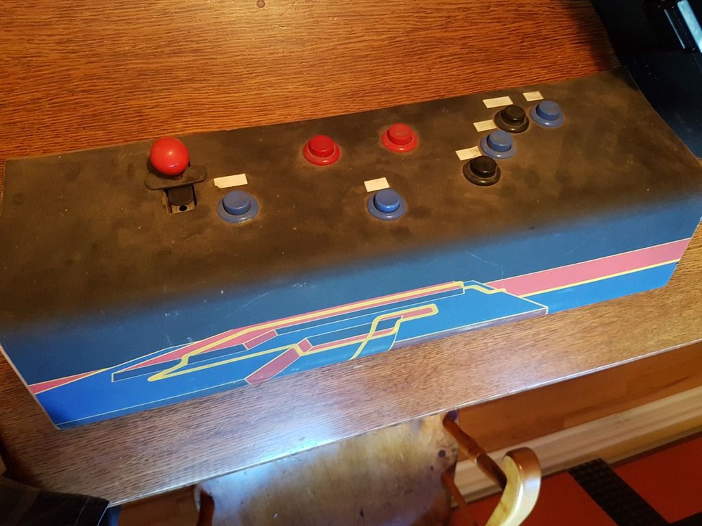

First thing, I had to strip off the really shady overlay. It was seriously ugly and wrecked. Someone had added labels to the buttons.

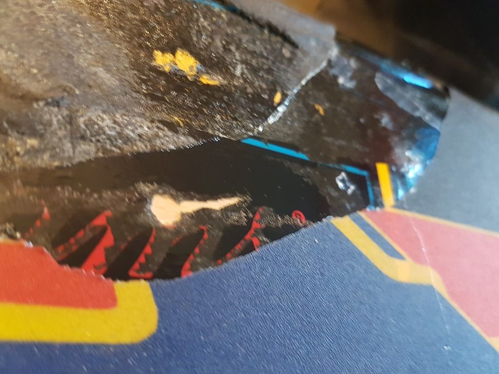

While stripping I found that the original was still underneath. I assumed it had been wrecked and the new owner just dropped the new one right on top.
I've never messed with a Williams control panel. Good grief, THE GLUE IS EVIL!!!!!!!
Once the overlay was off I spent a couple hours with rags and acetone to get all the adhesive off.
It's now all sanded and ready for some patching.
Question, I see people put clear on them as they were originally, but I also read about folks using a high build primer to make them really smooth and pop because of the white.
Thoughts if you've done it? I do need to bondo it for sure.

I'm now convinced I don't know what to do.
I'll start with patch and bondo.
Clear coat would be original, bond well and sand well. But wouldn't pop as well as white but is more original. I'll likely clearcoat, but maybe not.
