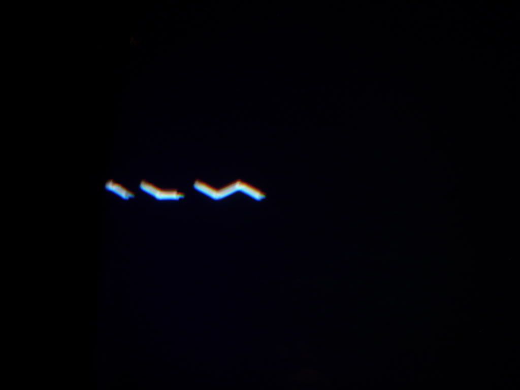

Ok have a board issue on my Star Wars. Powers supply and brick tested good with my new AR and Atari Brick tester. and the monitor tests great on my Tempest. I reseated the chips tonight. no change.
When you turn it on. It speaks sounds nomal. there is just a red vertical line on the screen. wont coin up or play blind.
in test mode. I get a noise that sounds like a siren, keeps playing over and over, here is a picture of what the monitor looks like in test mode.
Wild guess, Bad AVG ?
Is the "siren" consistent or do you also hear some low "boop" sounds in between ?
I will check. I dont think there were any low boop tones. The siren is consistant.
