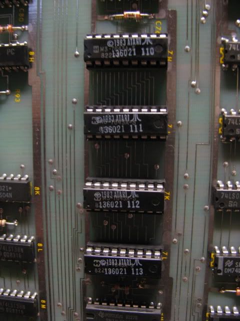

I believe matrix errors can be caused by bad PROMs, which commonly fail... but it's hard to say which one, or if that's actually the cause of your problem. If you know someone with another board, or a set of PROMs, it's probably easiest to just swap them and see if it fixes it.

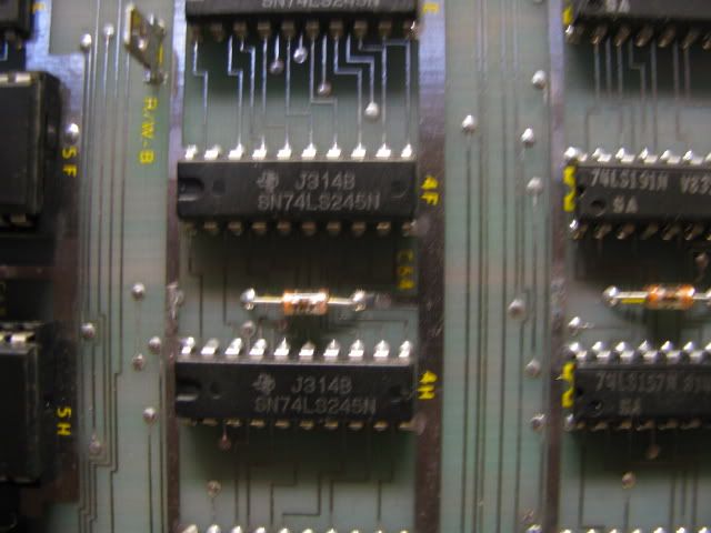

From what I read on the other thread, the 74LS245s can be a problem.
I booted the game and those two chips are running VERY hot, along with the 5 others in these photos:
the 74LS245s -

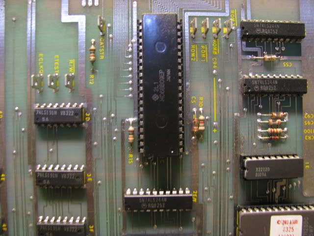

Should every chip on the board read ~5vdc? The long vertical chip in the photo reads at 3vdc, and I have another at 0.03 elsewhere on the board...

The large chips in your photo is the CPU chip...I believe it should run pretty hot normally? Anyone else?
The LS245 chips are part of the matrix processing according to the schematics. I was thinking to try replacing them, but I'll also check my working boardset when I have a chance to see if they still run hot on that board (might be a good clue!).
The other socketed chips are the PROMs. I tried swapping these from my working board, but it didn't help me...but you could try this.

Done. All voltages at the test points on the board are good.
That chip at 2C, which is listed in the manual as simply "microprocessor" is still reading at about 3 to 3.15vdc. Are test points different on this type of chip? I removed it, cleaned the legs and re-seated it, but no change in reading or display on screen.

Pull all the proms one by one and clean the pins to see if you can get it up and running. It's probably one of the proms but I can't remember which one causes no stars.
