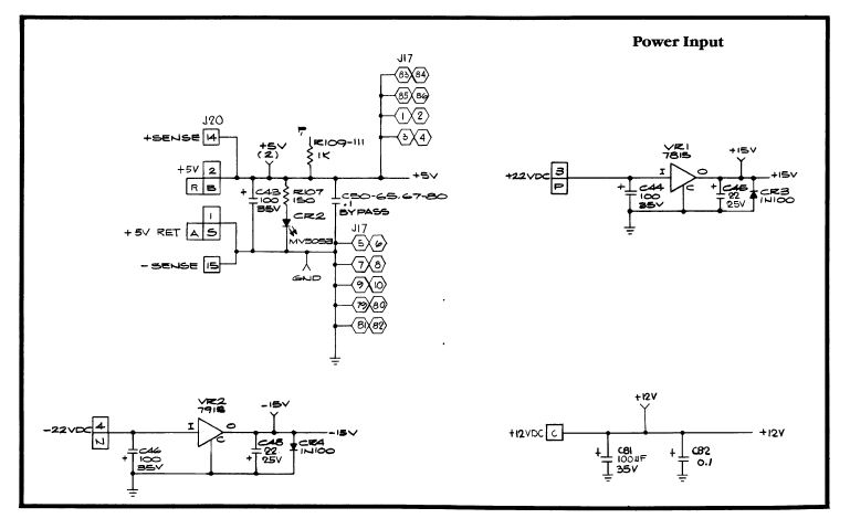

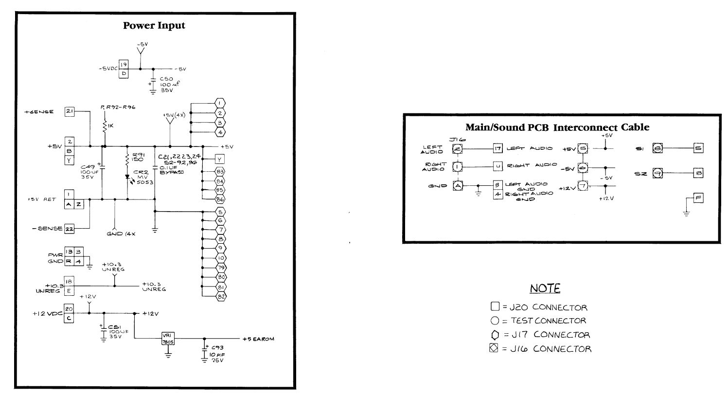

Also then test the on-board regulators - review schematic first so you know how many voltages are derived on the logic PCBs and where those are.

As for the regulators, there should be +15V and -15V test points on the game board, to check those. Near the video adjustment pots. There are also +12 and -5V test points on the sound board (i.e., the smallest of the 3 game boards).
