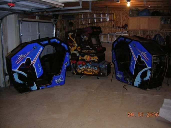

Just take 2 people and walk it up the ramped trailer. You won't be able to pust it up without the game teetering at the apex. I know a thing or 2 about moving Star Wars cockpits. Here's my garage when I was hoarding. Damn, I love these pics!

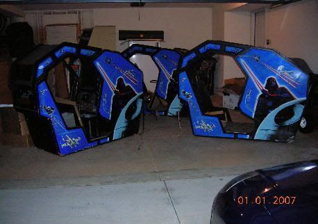

b_koenig is right, you do not want to push it in. I took the wheels of my cockpits and raised them up 1 1/2 inches. When I load them in my trailer, with a back door ramp they do not drag at all. They made these things so low that they will drag on a regular door sill.
